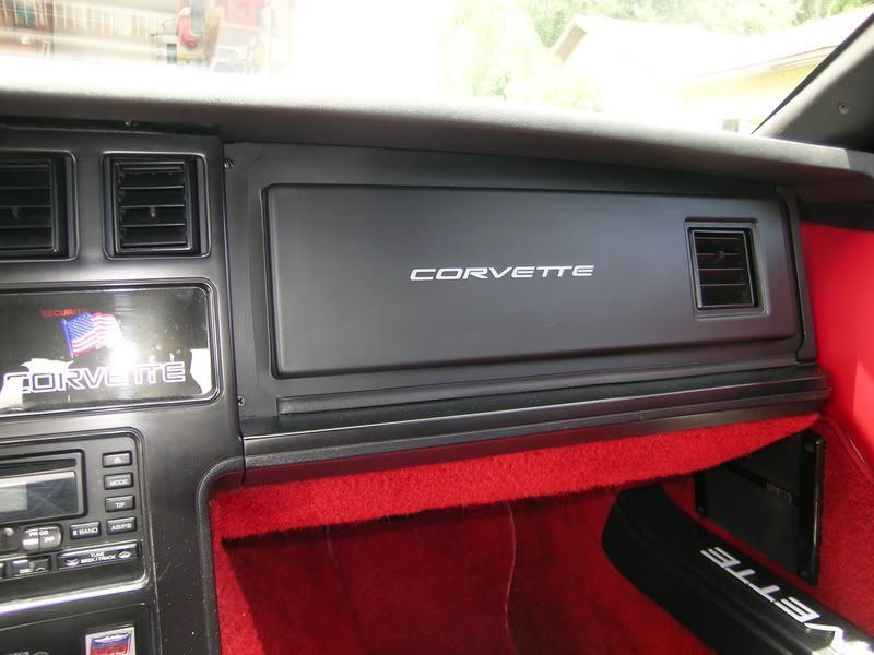

I bought my '89 last fall and it came with a panel for replacing the passenger side crash pad (aka Breadloaf) that the previous owner had never installed. I finally got around to installing it and wanted to share the results.
I'm thinking it needs an emblem of some sort...that'll be a project for another weekend.

Confab, I'm actually thinking about a gas cap emblem. I thought maybe cut off the outer ring and just leave the flag portion.
Bill, I'm guessing half a day. I pulled the dash pad; mine was a b!tch to remove. The instructions for the new panel suggested cutting the support brackets. I didn't want to do that. The top screws were easy with the dash removed, but I couldn't figure out how to remove the sound panel under the dash to remove the lower mounting screws. (The FSM made it sound like you have to remove the crash pad before you can remove the panel to remove the crash pad.) I ended up using a Dremmel tool with a cutoff wheel to cut the two bottom screws at the clip nut and the panel lifted right off. The replacement panel just slides in after that. The kit included a new AC vent tube which is white and can be seen in the picture. The instructions suggested some black spray paint to disguise it. I didn't think it would be as obvious as it is so I'll probably paint it at some point.

How's this?

That looks pretty awesome! I found
this one this one
through Amazon/Ecklers that I may go with. I'm a little hesitant to spend $40 for an emblem on a $50 panel though.
