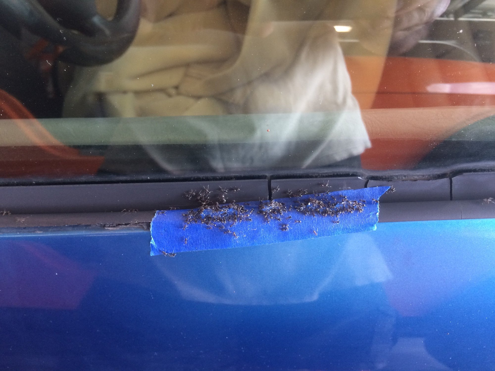

now for the strangest thing. I noticed as I was working that I kept getting these small ants all over he place. car has been sitting for a while. so today I finally decided to get rid of them. I have this poison from DuPont call anxion and it works like magic. it is a gel and the ants eat it up take it back to the home base and poison the whole lot. after about two days no more ants in the house. so I got it out and put some on the car, holly crap... took a quick video and a pic

I went through the same ant thing. Hahaha. I bought some traps that have that gel in it. I placed two behind the rear license plate, one inside the car in the back area, one inside on the front and then one outside the car on the cowl area. I also sprayed around each tire with spectracide ant killer. About a week and a half and ants were all gone. I found that lots of the ants were behind the old crusty weather stripping. I replaced ally stripping with a kit from Corvette America. It too had no clips (my 95 doesn't have bolts that hold the striping in place, instead idiot clips)
