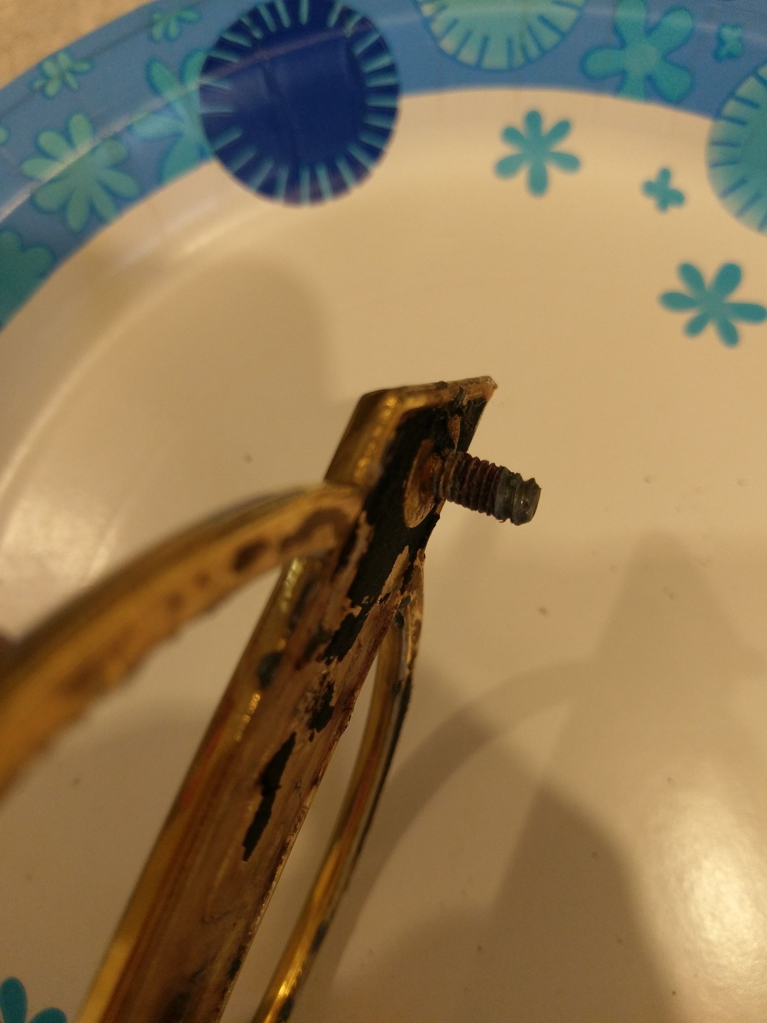

I bought new emblems to replace the horrid gold ones for my 95. The studs on the old ones are threaded with each a speed-nut attached. The studs on the new ones are not threaded. They are plastic and have foam adhesive pads on the underside.
Do I try and jam the speed nut on there or since the new emblems are plastic are nuts not even necessary? I mean I could go nuts and run a die on the studs, but I'm thinking it's overkill.

Speed Nuts will usually cut their own threads as they are twisted on, especially on the plastic studs.
Look at your old ones closely, and you'll probably find they aren't really threaded like a normal nut/bolt would be.

The 'original' emblems I don't think are original at all. They are metal and gold in color. They are definitely threaded. It makes sense that speed-nut will thread on. Thanks

as said above speed nuts cut threads as you wind it on. while the emblem is off start and cut threads on the studs. so when you install its makes your job easier

That's the plan now. Thanks. I removed the gas lid emblem. I'll remove the hood emblem tomorrow. I'll install the new ones after I buff the paint.

The gold emblems are aftermarket and usually added by the owner at some point. Usually these paired well with polo green cars and dark red metallic. Nobody makes the screw back emblems anymore they are all plastic pins. Simply go to ace and get the larger aluminum chase nuts that cut a thread into these plastic posts. Don't over tighten the emblems or you can snap the posts. GC

I took the front emblem off today. A much pleasant surprise that it fell off when I took the second nut off and left no glue behind. Total opposite the rear emblem.
