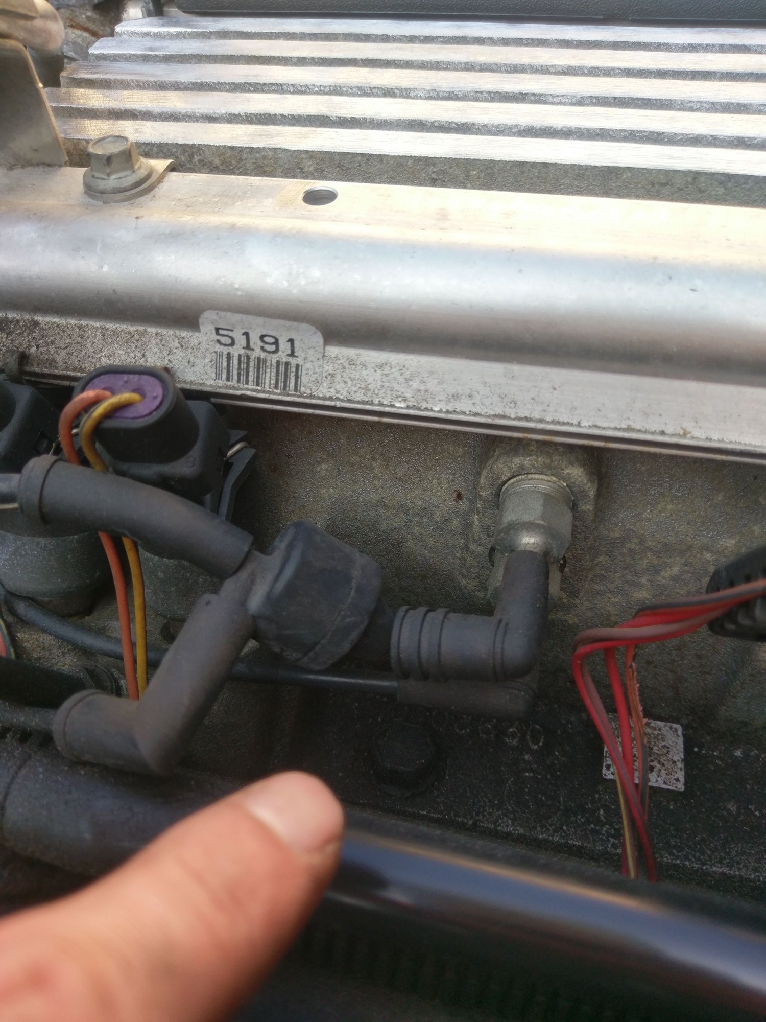

Was giving my new to me 95 LT1 a once over under the hood and came across this broken fitting. It's broken in the middle between the 90 from intake manifold and larger fitting.
Question, where do those vacuum lines go? Car has no issues as far as I can tell with exception to the HVAC system occasionally staying on defrost vent.
I'm going to replace the fitting, just curious as to where that line runs to.

cruise control and interior HVAC. If actually broke I will bet the cruise does not work. Dan

Hmm might be my hvac issue!

might want to check your injector wires. It looks like a mouse chewed on one. Dan

Sure does. Can't believe I missed that!

I had the same broken fitting and also had a wire chewed by a mouse in the exact same place. Weird. Dan

Here is the valve you need:
http://www.ebay.com/itm/Vacuum-Check...5ZpU1J&vxp=mtr
You can probably find this at Advance Auto or most other parts places that carry the Dorman line of HELP Parts.

You should be able to get the vacuum check valve at any auto parts store for about $4.
