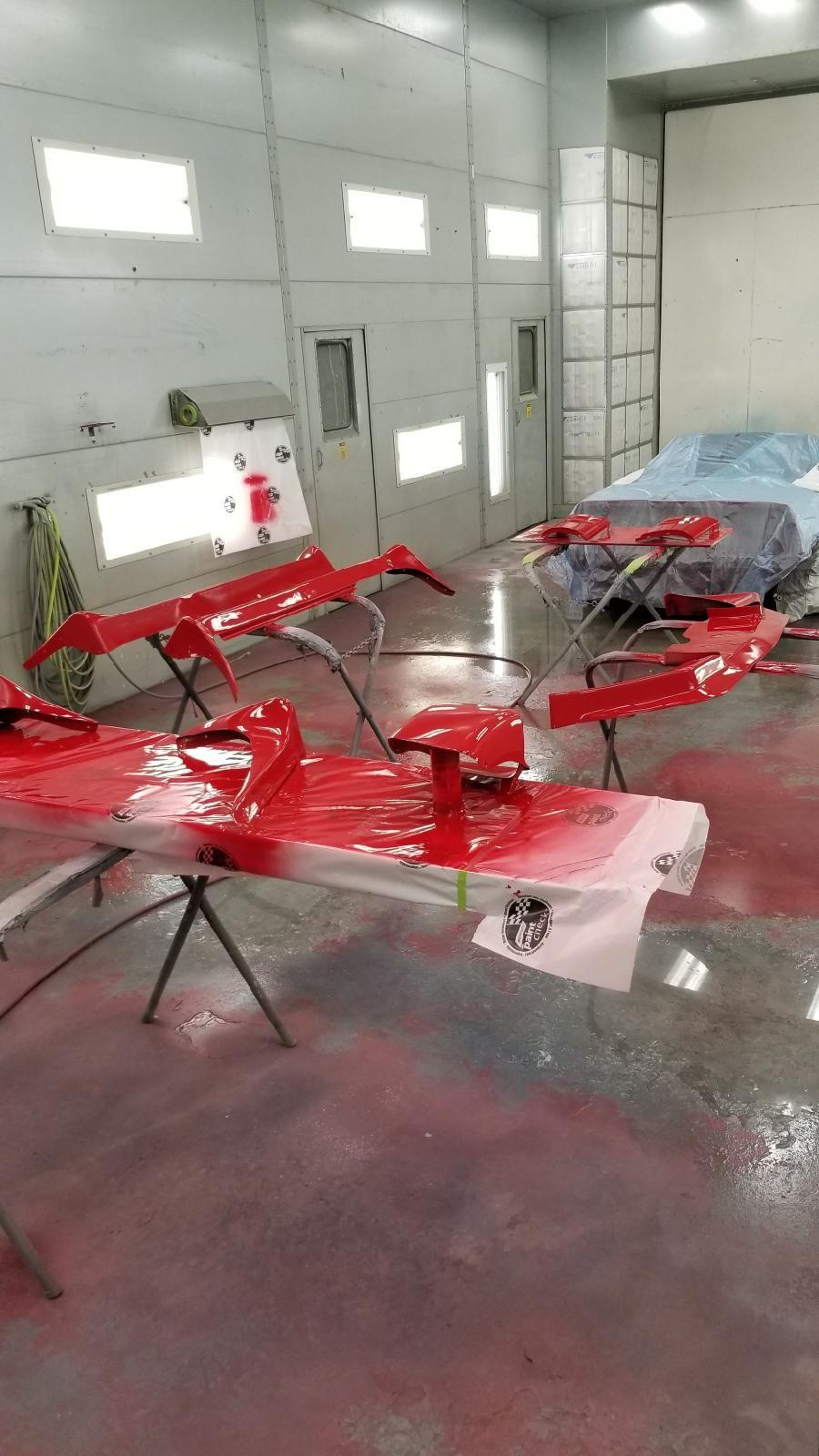

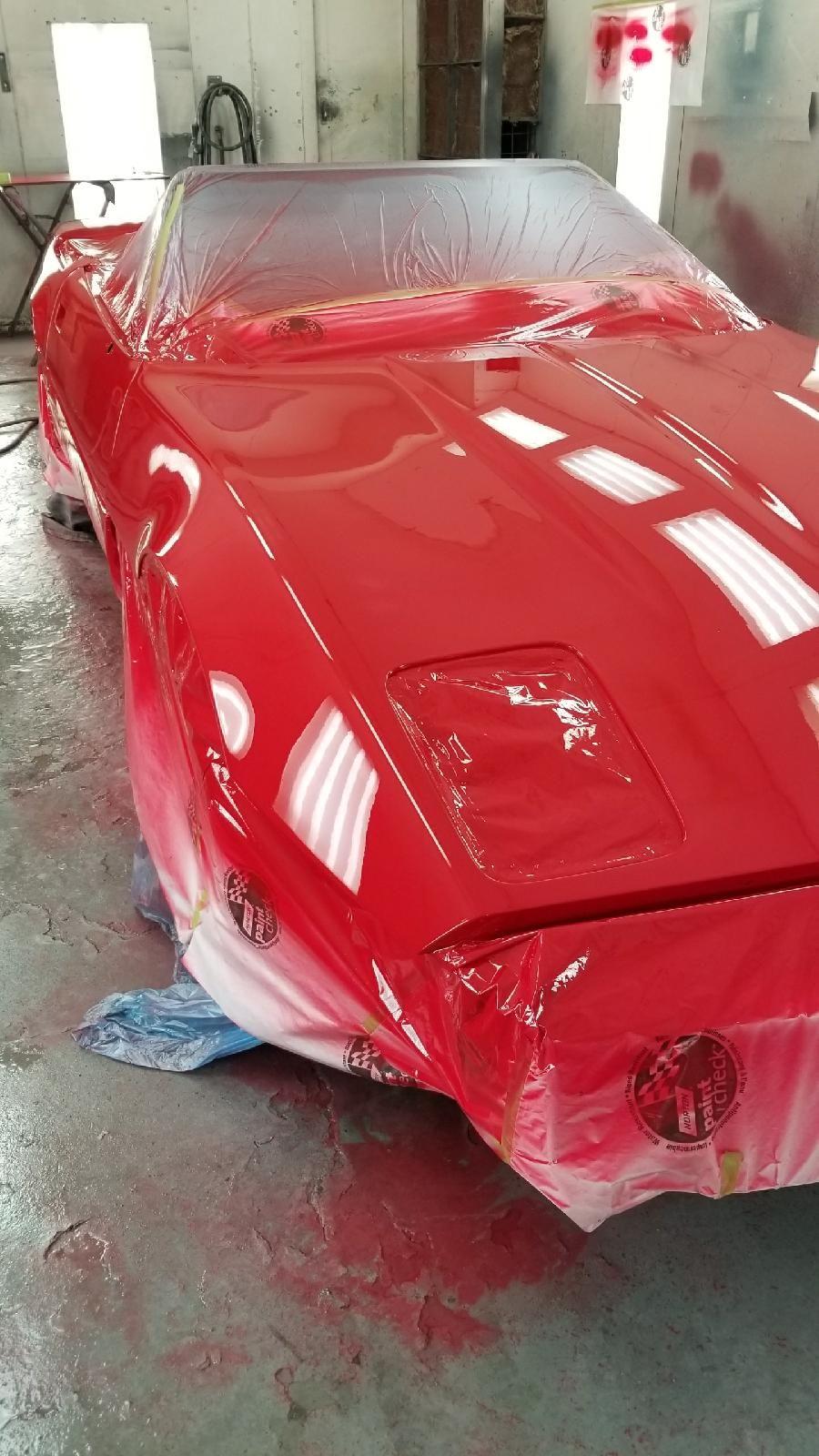

Looks like the painting is done soon reassembly
Ill try to find the pics of how bad the groind effects were to what they looked like primed

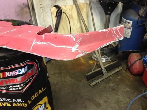

Thats just the front lower valence. All those lines are cracks the old man ground out and refibre glassed. The ends of it were broken and basically non existent so he built some new ones with fibre glass. She was in pretty rough shape
