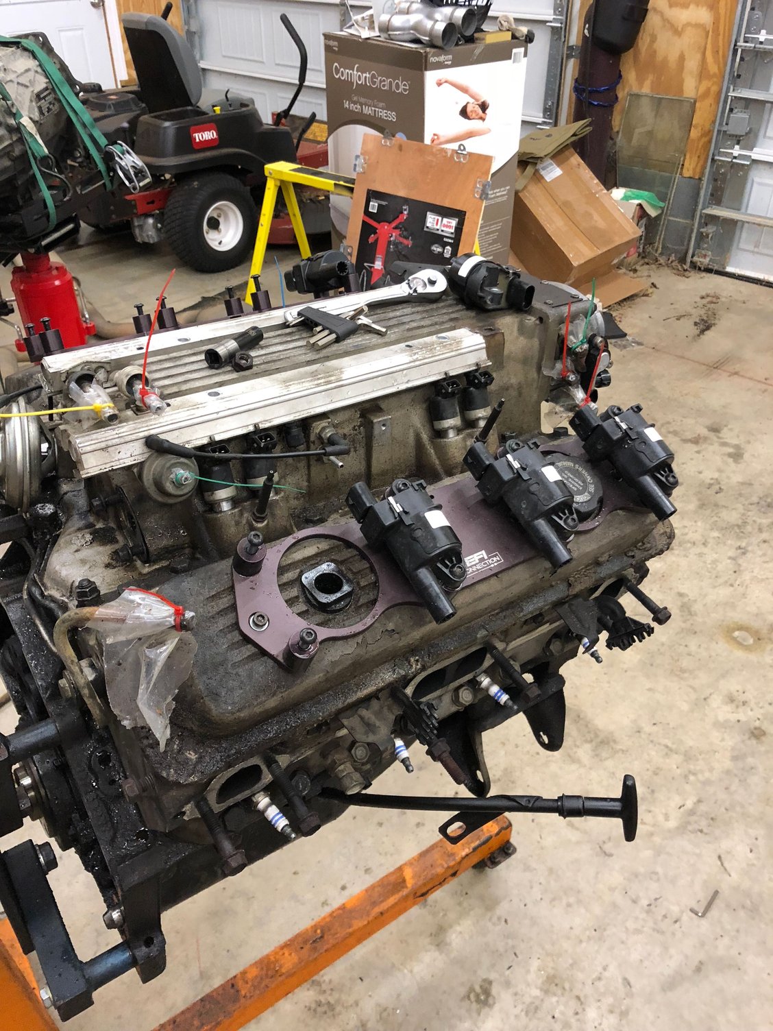

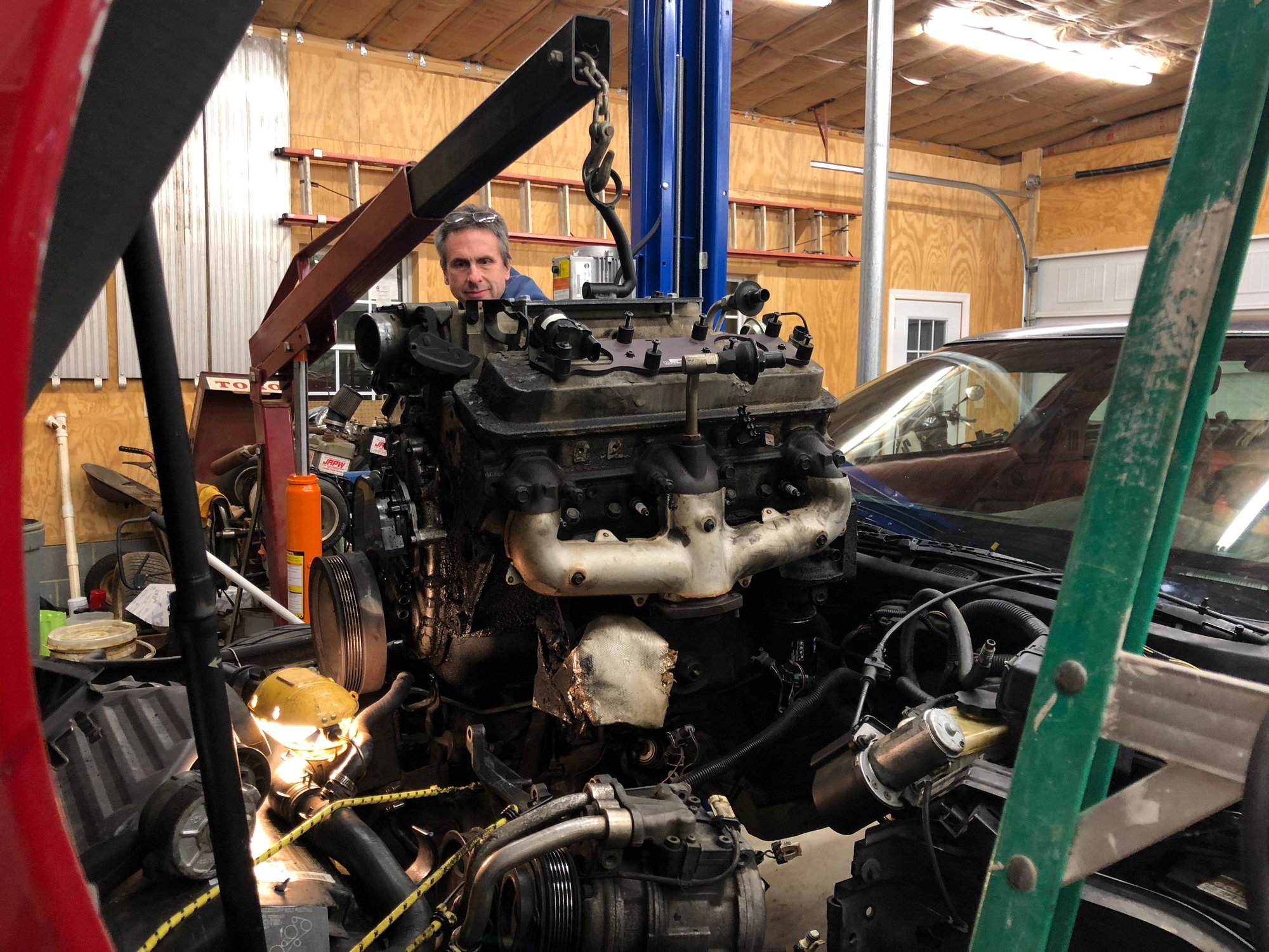

Pops giving me a helping hand!
After a decent cleaning. Tomorrow morning starts the front hub seal, timing cover seal, intake manifold gasket, valve cover gaskets, oil pan gaskets, and new headers!

I’ve got this job coming up hopefully next winter for a cam swap so this has been a good thread to see, thanks for adding pics. I’m hoping to be able to pull it with the belljousong still attached but we’ll see. I have the happy hooker as well.
Noticed you have LS1 coils mounted to the valve covers with the EFI connection brackets. Their website last I looked said something about not working with LT1 valve covers due to a unique grommet. Did you have any issues?
