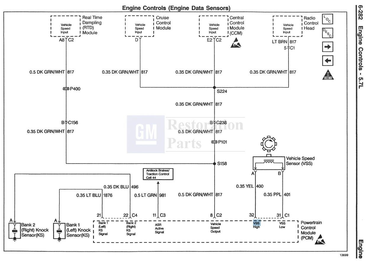

Originally Posted by PatternDayTrader
I don't remember the PCM feeding the speedometer its input.
It does. The VSS first sends its analog signal to the PCM, which converts it into a digital signal. The PCM also uses the speed signal for certain running parameters, such as deceleration fuel cutoff and the way to handle drop-throttle idle while the car rolls. If you unplug the VSS, the engine will probably stall when you lift off while rolling (at least in a manual-trans car). Anyway, the PCM then passes along the digital speed signal to the tach, cruise module. and one or two other things (I forget). This is true for 94-96 cars, at least. I don't know if it's true for earlier PCMs.
Old Jan 1, 2018 | 10:21 AM
PatternDayTrader's Avatar
PatternDayTrader
Joined: Oct 2008
Posts: 17,982
Likes: 1,074
From: Lansing MI
Ok, so no vss buffer on 94-96.
Old Jan 1, 2018 | 11:01 AM
MatthewMiller's Avatar
MatthewMiller
Joined: Aug 2015
Posts: 6,102
Likes: 1,981
From: St. Charles MO
Correct, at least not separate from the PCM. Here's the schematic:

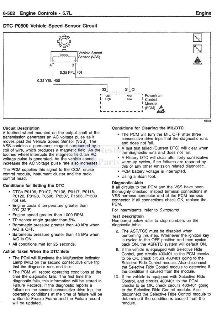

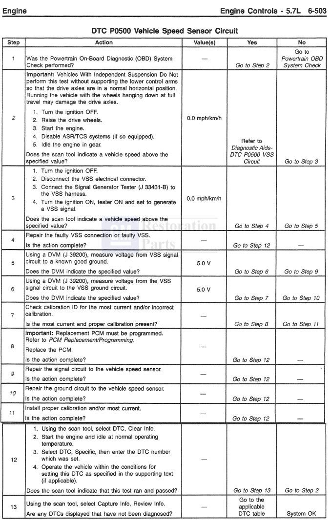

Old Jan 1, 2018 | 11:13 AM
MatthewMiller
Joined: Aug 2015
Posts: 6,102
Likes: 1,981
Here's the description and diagnostic chart while I'm at it. Note that "Replace PCM" is a clear step to take, depending on the results of the diagnostic steps.
Old Jan 1, 2018 | 11:21 AM
PatternDayTrader
Joined: Oct 2008
Posts: 17,982
Likes: 1,074
From: Lansing MI
Yeah very simple two wire circuit. Not even a connector in between. It will be a shame if this was diagnosed incorrectly.
Old Jan 1, 2018 | 11:27 AM
PatternDayTrader
Joined: Oct 2008
Posts: 17,982
Likes: 1,074
From: Lansing MI
Real interesting footnote on steps 9&10 about selective ride control. Easy place for someone to blunder I guess. Its not represented on the wiring schematic. Not an excuse for diagnosing this wrong if that turns out to be the case.
