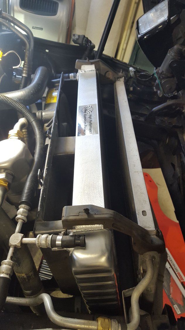

Decided I want to replace the radiator in my 92 when I decide to start the work on it. I know Dewitts is the is the way to go but I really hate to spend over $500 for the radiator I want. What else is out there that can handle keeping the LT1 around 200 degrees? Yeah, I know LT1s are supposed to run hot (emissions)but, cats are gutted and smog pump is deleted, and I really don't like the fans running all the time in hot weather.
Originally Posted by PatternDayTrader
You could replace it with a stock radiator. Why don't you do that ?
The stock radiator can handle keeping the LT1 around 200°
Here is an LT1, running ~75 mph, AC on, on a 104° afternoon...

I want all aluminum. Mine cools as intended but I want it to run cooler, without turning the fans on earlier. And yes, Its a six speed and will want a dual core probably.

Old Jan 9, 2018 | 09:44 PM
Tom400CFI's Avatar
Tom400CFI
Pro Mechanic
Joined: Aug 2004
Posts: 21,543
Likes: 3,216
From: Park City Utah
Originally Posted by aklim
How is it in stop and go traffic, mostly stop? At 75, it would but I had more issues with running AC and stop and go or major traffic jams
As one would expect, the temp goes up. If there isn't air flow through the radiator, the temp will go...up, no matter what radiator you have.
In temps like those from the day that I took the pic, I'm typically running my AC, so the fans run and in that 'mode', the temps seem to hover around 195-205.
The last auto-x I did, temps were in the mid-high 90's. My wife and I dual drove the car, so the car go no break/cool down. I ran the AC in the grid and the highest the temps got in that mode (low speeds, high loads/rpm, with brief idle times) was 215.
