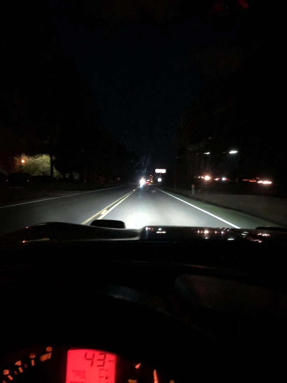

I'm running Genssi GEN-7X6-PRO-BLK from ebay. They are literally night and day no pun intended haha. Took me about 20 minutes to install them.

How is the beam pattern?

The beam pattern is pretty nice. I can send some pics when I get home tonight.
Connor
please do. I want to upgrade my headlights

Likes: 59
holy ****. wow

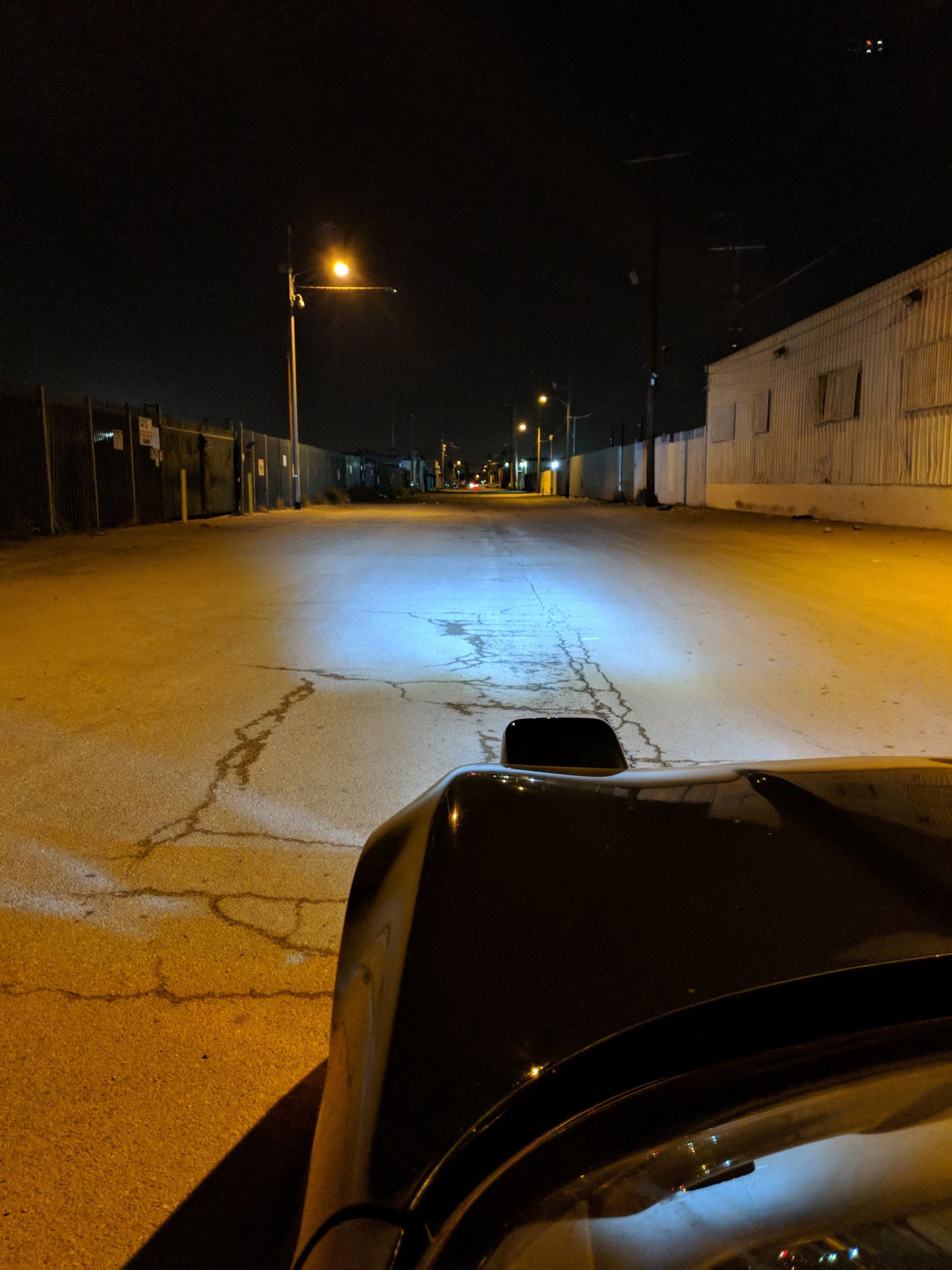

ill post pics of mine. gonna go to my usual alley for some headlight adjusting. (has a perfectly smooth white wall where I can align them )and maybe a spirited run or 2

Quick pic
will adjust more and I need to install my fog lights
