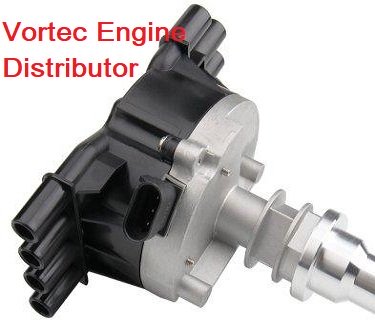

There is room, b/c people run small cap HEI's on Gen I SBC's with a "converted" LT1 intake.
The problem is the pick up. A typical Gen I uses an 8 pole magnetic pic up...which the LT1's PCM won't read/understand or know what to do with. As we know the OPTI uses a LED and photo cell pick up, and produces 720 points of reference per revolution on the hi-res side and 8 changing length (cylinder "ID") points of reference on the low res side.
They're incompatible with each others' ECM's.
The cheapest conversion you could do would be to use a junk yard distributor that will house the OPTI's wheel and sensor, then mount those two items in the conventional distributor. Modify the LT1 intake to accept a conventional distributor, and then seal the OPTI drive hole in the timing cover....problems solved.
Now you've got an OPTI mounted out of harms (water) way, easy to access and service, and it's still compatible w/the LT1 ECM and provides the more tightly controlled angle based timing.
This is the plan I will pursue someday when I build a 400, for my LT1 car, and I was thinking about the L31 Vortec distributor, for that due to the low profile, "correct-a-cap" cleanliness and readily available in salvage yards.

Thanks. Now I'll have to Google L31 and learn what I can.
My big issue is the multitude of posts talking about Opti failure, and the few posts claiming aftermarket Opti longevity.
I've got a mill in my garage, so making the modifications is just a matter of buying the right tooling.

Cool. With a mill....you can do a LOT.
You don't hear about Opti "Successes" b/c people rarely post about that. They only post when they have issues. My stock OEM opti lasted over 150k miles; 50% longer than GM said it should. That's a success, IMO. The napa unit that I replaced it with lasted 5 years/~30k miles. That was...fair and for the price ($500) it was poor -a failure, IMO. I brought the "price-to-longevity" ratio into what I feel is an acceptable range when I bought my current one; a SAC CITY unit with a 2 year warranty. If it lasts 2 years for ~$160, that's O.K. with me.
If you get the thing mounted up in a conventional, rear mount distributor, I'd bet that it lasts indefinitely; it'll be cooler running, stay dry, and if it does get wet/contaminated, it's 5 minutes to get to it to clean it...not an hour. My wife used to have a Dodge Stealth RT/TT (remember those?) and it had an opti in it, but mounted in a regular distributor mounted/driven off one of the OHC's. It lasted indefinitely, except that I got it wet washing the engine once. I took it apart, drew kleenex tissue through it to dry/clean the lenses and it worked flawlessly after that. Same/same on a Nissan Xterra I worked on for someone, too.
So, *I* think a standard/rear mount opti converted distributor will make a great working solution.
EDIT: THE L31 distributor's internal sensor is only for cam orientation; it's a "cam sensor". The L31 has a crank sensor that provides the "Now, now, now, now..." for the ignition events and injection events. Anyway, that cam sensor wheel and pick up that are in the L21 distributor would have to go, or be cut down so that you could replace them w/the opti counterparts.
