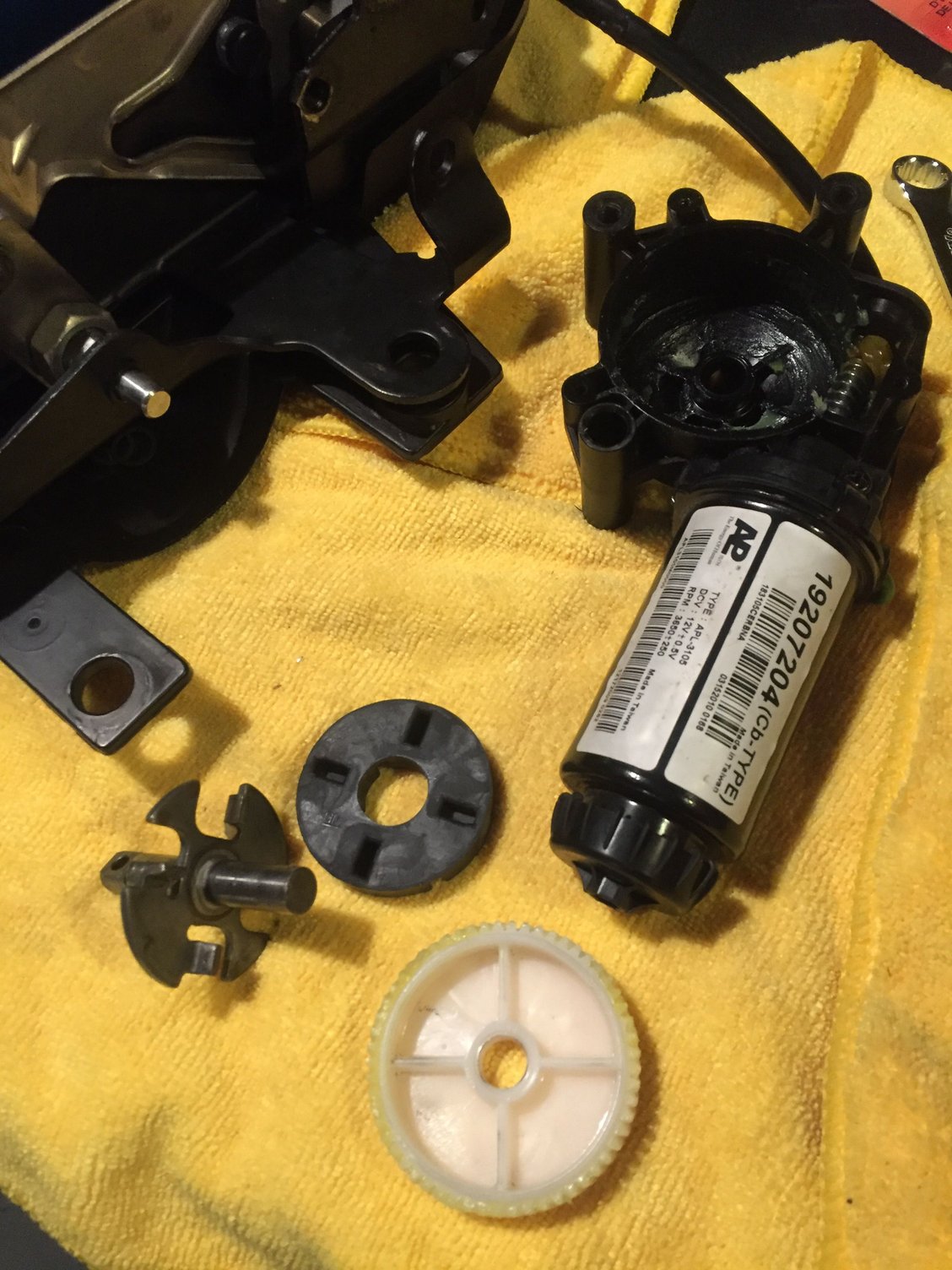

Well I think its clear why my headlights stopped functioning...
What would the recommendation be as far as choosing between a brass replacement, or nylon?
And any recommended vendor to order these from (i'm in Canada)?

mine looked the same on my 94
there was even dust under where the motor is outside of it. if gears are good, replace the pivots. $8 on ebay
if gears are worn go with aluminum gears and new pivots.

The gears are not the issue its the pellets that turn to dust. I would just replace with nylon gears when you replace the pellets.

my 94 had 1 gear a little worn, plus I ordered the entire kit as I wasn't sure what was needed. on my 92 I ordered the pellets only. should be here tomorrow

Both of my gears look perfectly fine, so I’ll just be replacing the pallets. I ordered a set this afternoon, so hopefully they’re here in a few days time.

I think that sometimes though the gears may also be a problem particularly if a PO has replaced the original OEM Plastic shell, Plastic lens headlights with the "relatively" much heavier (albeit much brighter ) glass sealed beams. So if you have the heavy glass headlights you may want to consider upgrading the gears as well. Just something to consider.

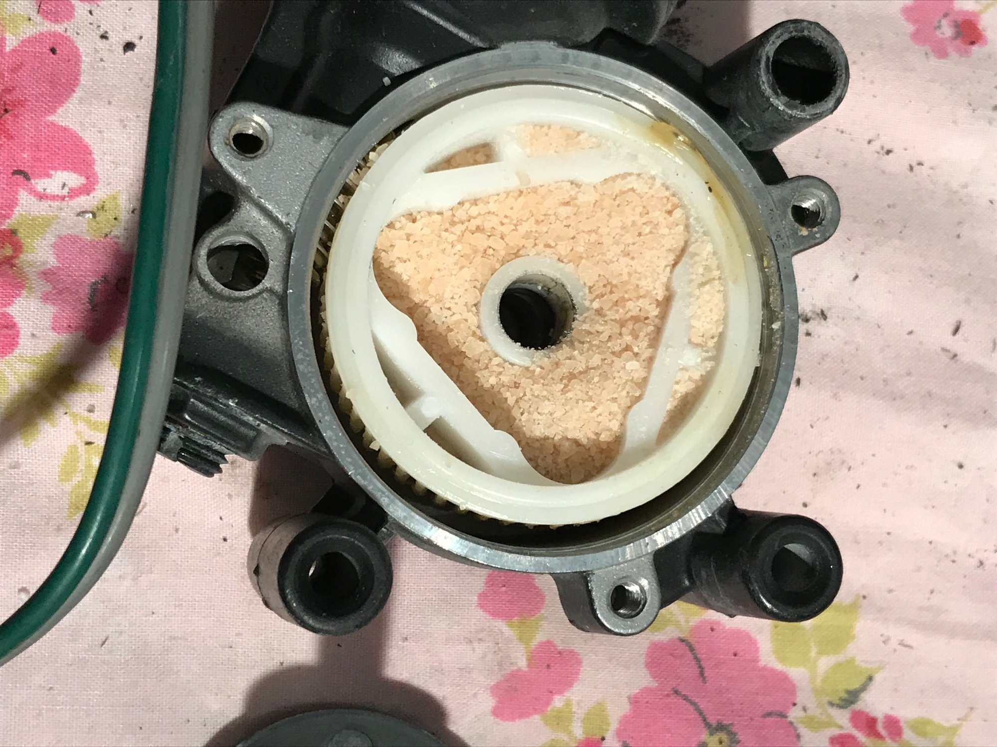

Those pellets should be outlawed. I pulled my motors for pm check, no pellets here. PO replaced the motors, which has a C5 design with rubber bumper. all set.

My lights are starting to act up also. They still go up and down but are starting to ,bump bump bump bump when they park or even when I just have the driving/parking lights on and then turn them off. Has any one come up with a home grown replacement for the pellets?

There's pellets on ebay, or HELP 74410 on amazon

Mine is a 90 with 17000 miles, always garage kept, and that was the result when I opened the motors up the other day. Others can chime in, but I think it’s more time that causes them to break down.
