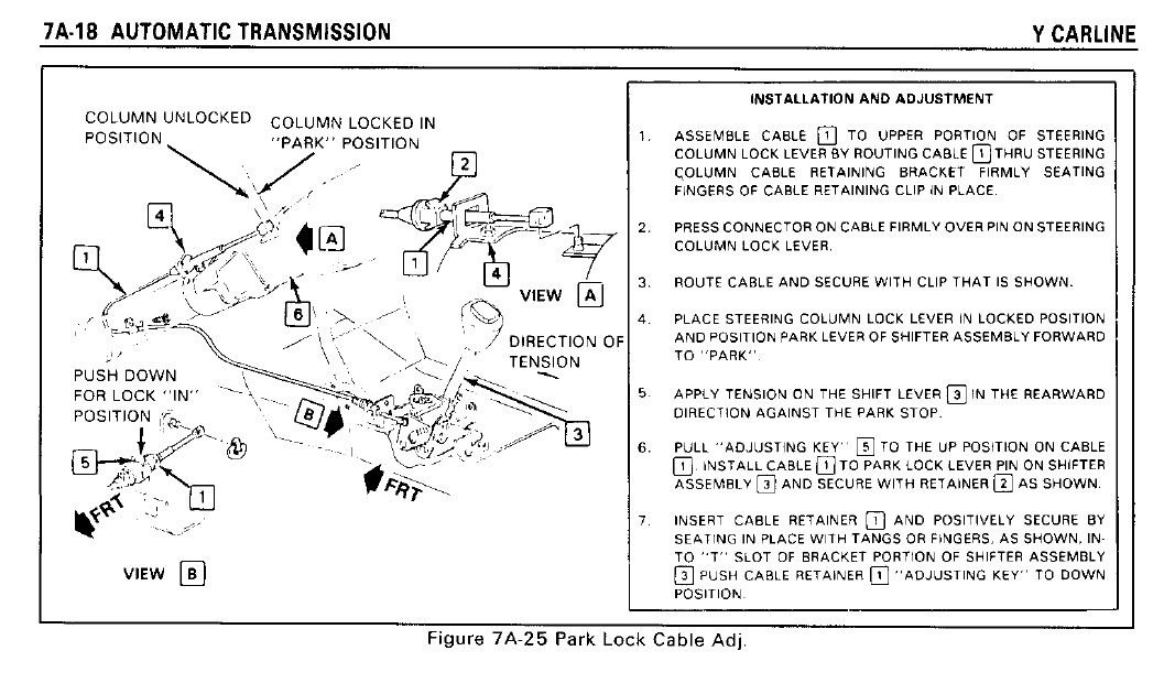

There's a lot of focus in this thread, including by the OP, on the ignition when the problem stated was "I need to get this car into neutral"
To get it in neutral you disconnect the park lock cable from the shifter. About a 10-minute job.
