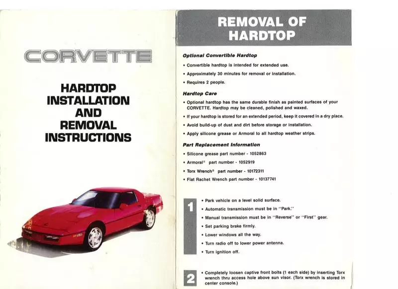

See below:
Originally Posted by aboatguy
Scan of the factory instruction pamphlet for top install.
