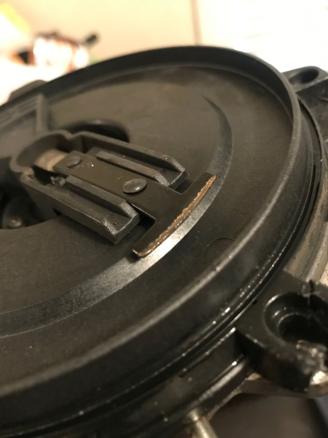

Doe this mean the optispark is trashed ?
All post inside are partially fried

You may just need a new cap and rotor. If you replace the rotor be sure to use blue Locktite on it the screws.

What brand opti is that? Looks the first opti I took out of my 93. Sometimes you can't tell they are bad by visually looking. Sensor could be bad. On one of mine, if you spun the rotor by hand, it would wobble. Which putting a new one and the car ran fine.

Mine ran great but had a wiggly bearing so i replaced it with an AIP unit. I cleaned and swapped in my Mitsu sensor. All is well and I have the new AIP sensor as back stock.
Main thing is don't bolt it down if it's not perfectly flush with the timing cover. Ask me how I know. Also, fire it before you put on the water pump. Will save you hours of headache.

don't forget, the oem ones can be rebuilt, upgraded and use the mitsubishi sensor. if you price the cost of an MSD cap and rotor ($150.00 plus depending on source) then the rebuild service is not too bad all considering what you get

And no, you're pics didn't not mean the option was "trashed".

Take a picture of the opti sensor so the experts can tell you if it is the good one or junk.
