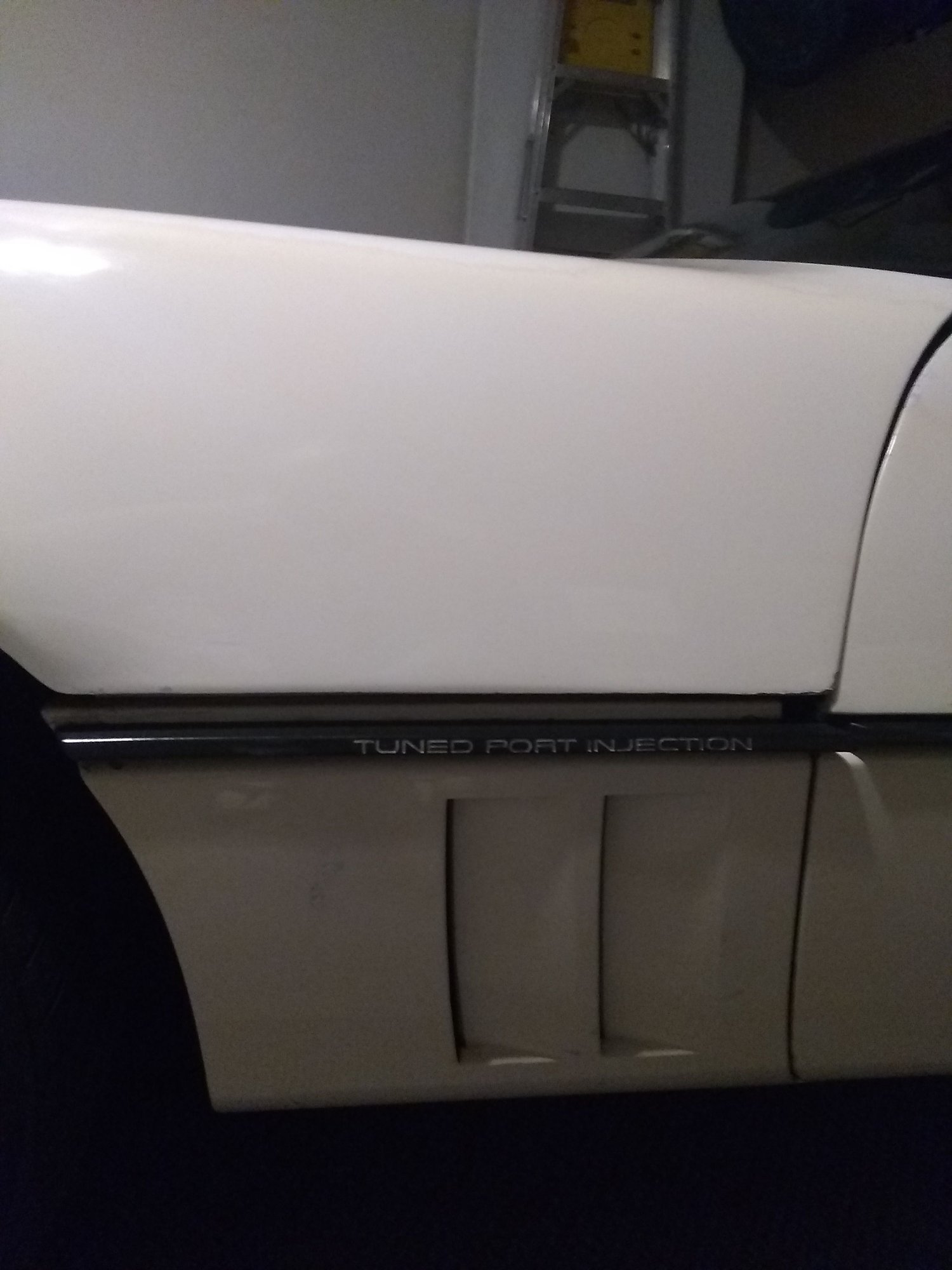

Okay I replace the hood springs on my 85 about 2 years ago since then I have to push down on the driver side and pull the hood release at the same time for the pop up and then when I shut it and drop it the left side I have to push down on and it still doesn't go all the way down there's about a half an inch to it three quarters of an inch gap between the trim and the bottom of the hood only on the driver side the passenger side is fine I have to replace the driver side Hood hinge which I plan on doing the next week or two I need to know how to adjust this thi play closer to the trim on the driver side I don't care about pushing it down a pop it up that's fine I have the emergency cables I just need to know the adjustments to make to get this thing to sit more flush

Old Dec 8, 2018 | 03:43 PM

Old Dec 8, 2018 | 05:31 PM

What's the nose look like, top down?

I replaced the hood springs on my 85 about 2 years ago
What springs did you replace?
there's about a half an inch to it three quarters of an inch gap between the trim and the bottom of the hood only on the driver side. I have to replace the driver side hood hinge.
Has this car been in a collision? You'll never get the hood to fit right if your hood hinge is messed up.
(There is a "period" button somewhere on your device. I challenge you to find it!)

I found it... I bought it 5 years ago bumper sits a little higher than the hood, and the springs are the ones at the back of the hood. I am changing the drivers 's side hinge it's sloppy and when it's open the hood can be wiggled . After I replace that I will see what happesn. .thanks though, and I apologize to the English teacher.. lmao
