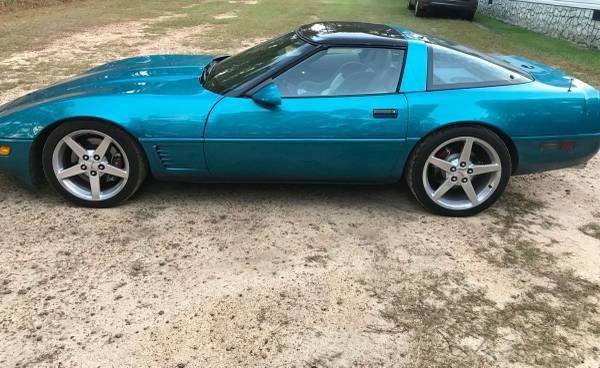

Hello everyone and thank you for having me in your community! I'm a perspective 1st time Corvette buyer and I've been interested in owning a C4. I found a car I want and would like opinions on whether this is a good buy or not.
1995 Corvette $8500
I have this nice vette for sale or trade. I have done a lot of work on the vehicle to get it in really good running condition. Contact for details. Lots of new mechanical parts.
Trade interest are mainly 4 door 4x4 trucks, or Jeep Wrangler, but I will be glad to consider any offers just shoot me a text.
Current cons:
Rip in the drivers seat. Shown in pic.
Needing head light motor. They will open but sometimes gets hung up.
Other than those things, this car is solid!

With the miles, but add the fact that it's a 6 speed (with the stronger rear), and the seat condition, without seeing it in person....I'd say 7000 to 7500ish.

Normally I'm the guy who says cars are reasonably priced. In this case, I agree with the above. 8500 seems like it's a bit high. If it didnt have the seat issue, I'd probably feel a bit differently. I think that 7500 would be a fair price if the car is in good shape in person.
The other thing worth noting is it has c6 wheels on it currently. I'd want to know a little more about them, size wise and tire condition wise, as tires for those are easily a grand, quite a bit more than for stock c4 wheels.

The text message says the clutch was replaced with aftermarket parts. If not done right those can cause a lot of rattles. Make sure you get a good test drive in on this before you make any deals.

Few things, first you want to check under that dash carpet cover, probably there to cover up problems. Ask him if rear main seal was done while doing clutch. I run C6 rims on my '96, 19 out back 18 front, looks like he did the same. Looks like he has wheel adapters installed, make sure they are proper adapters and not just spacers with longer lugs. I like the bigger rims but some people don't, you will feel every pebble, but they do seem to handle better IMO. Lastly, I wouldn't pay more than $6K for that car.

Lift up the dash pad, if its cracked up under there, I would say 7k at most

How many other C4's have you looked at and driven? My personal thought on buying a Corvette Like others here on the CF) is that you should find the best car that you can for the money you want to spend. For this car, I would avoid it because of the high mileage and the damage to the driver seat. Fixing the seat (or both seats) can easily run up to or even over $1000. Check the tires to make sure they are not older than 5-7 years. Brakes? good shape, lots of pad material left and good rotors too. Check the suspension components for worn out bushings or old worn out shocks.
Even if you get the car for around $6K, it could be that it would cost you another $2K or more to get it good condition. My .02 cents worth!!
