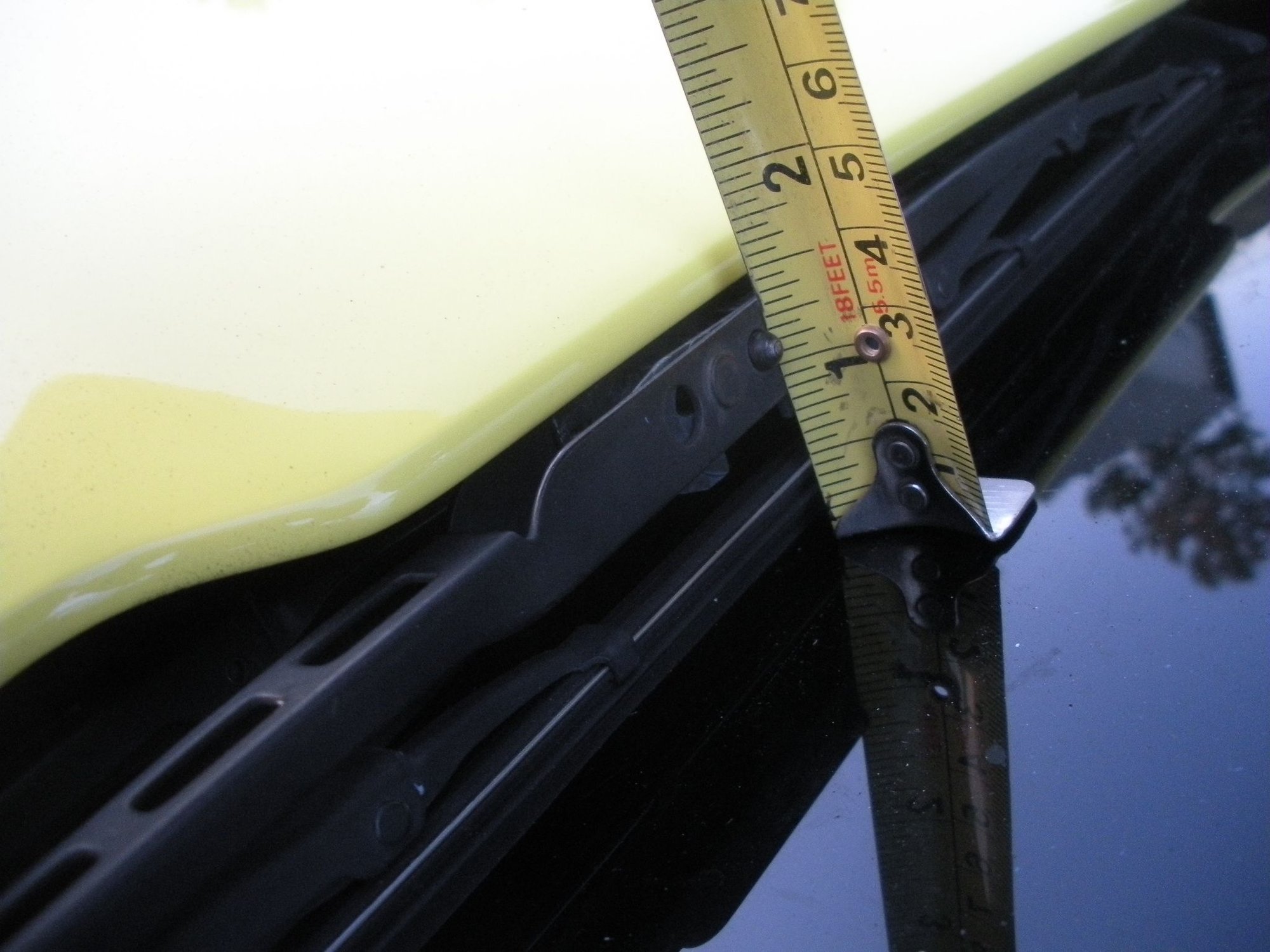

This may come off as a stupid question, but do C4 corvettes need special wipers? My driver side wiper is getting hung up on the hood cowl, thus stopping them from working. With the hood raised, they work just fine. Wasn't sure if there is a low profile wiper we should be putting on the car. 1993 Corvette.

Not special per say, but low profile, just bought these for my 96

We purchased ours from a Chevy dealership. Was no more expensive than the chain stores AND they fit the first time. The ones from the stores all said they were for our '96, but they hit also.
The listings the stores carry are often incorrect. We have to purchase the rear blade for our '18 Equinox from the dealer as the stores all list the wrong sizes and don't carry the appropriate one even in the right length.

Those are the correct blades for your '96. but the wrong blades for his '93! The mounting hole is the wrong diameter. The '84-'94 require the Trico 20-2, ACDelco 8-2202, or the Michelin "High Performance" 20" blades.
