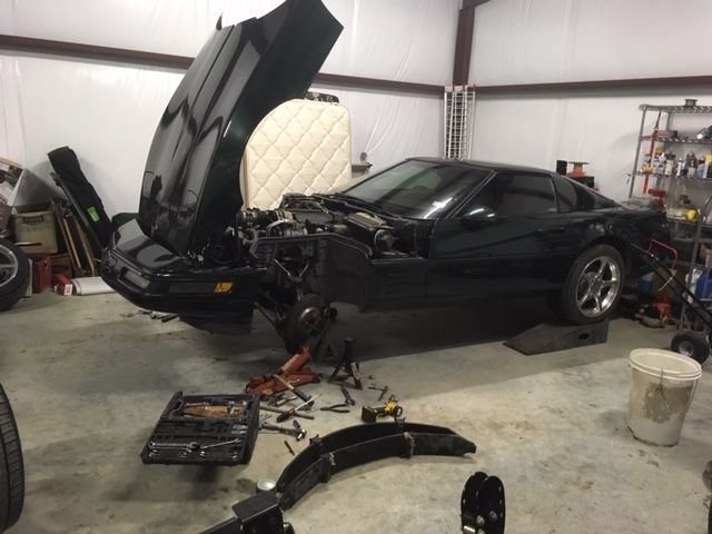

Old Apr 13, 2019 | 10:57 PM
Tx_94vette's Avatar
Tx_94vette
Joined: Apr 2011
Posts: 209
Likes: 31
From: east of dallas
Default replacement in progress
got the replacement spring this week from a ebay purchase, pulled my old spring out and compared them. Looks like someone had done some modifying to the original not much of a arch to it. Main thing about removal is getting the car up pretty high, will post when I get it back togetther
