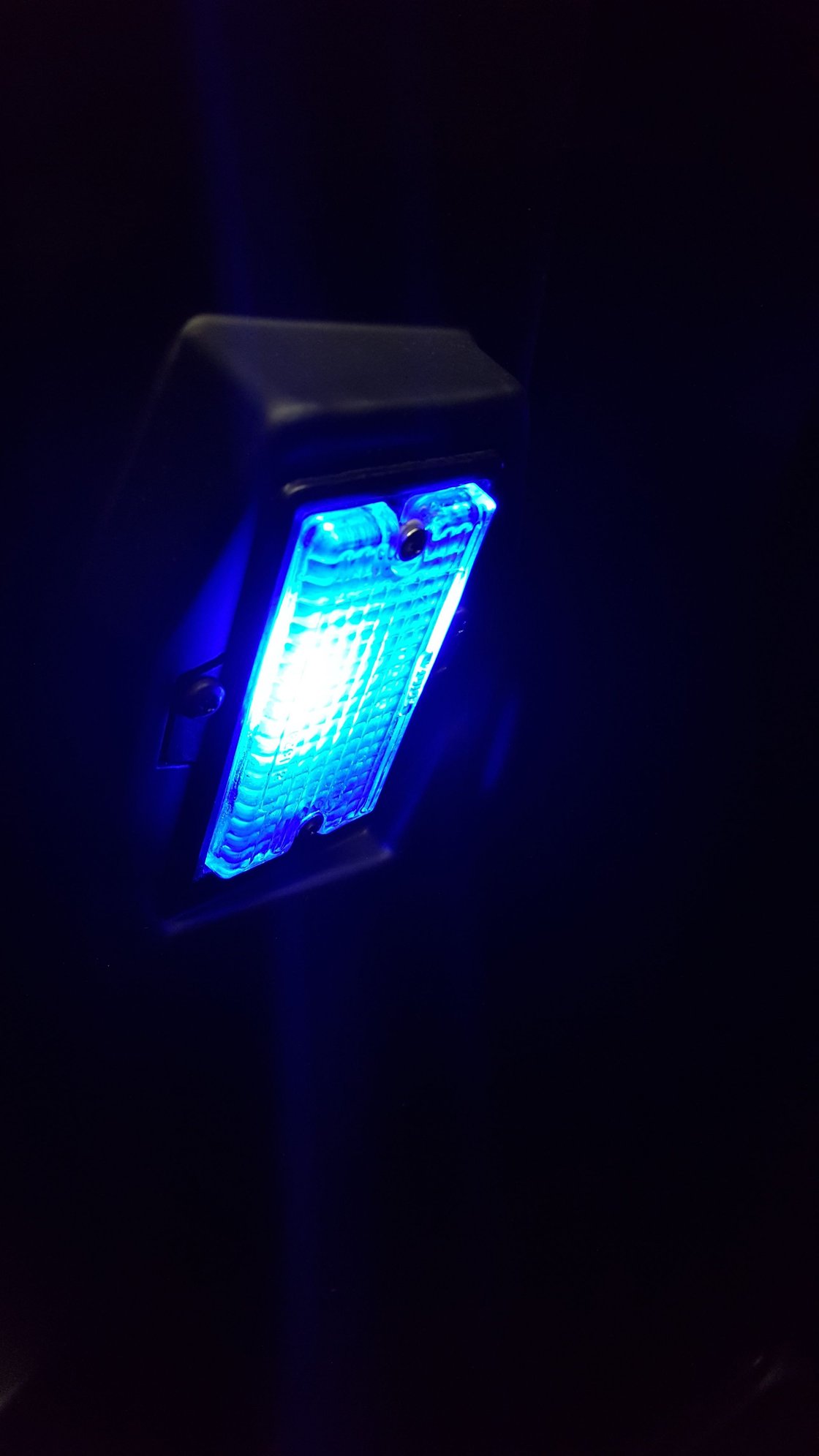

Originally Posted by Zeeman
With having 2 lights involved & bothhaving their own connector, would you have to buy 2 switches then? If I go that route? Love the idea with the LED’s..👍
I highly recommend the led conversion. Not just to save on the battery drain but to have REAL lights for a change.
This is in pitch black nighttime with no light other than the led under hood lights.
