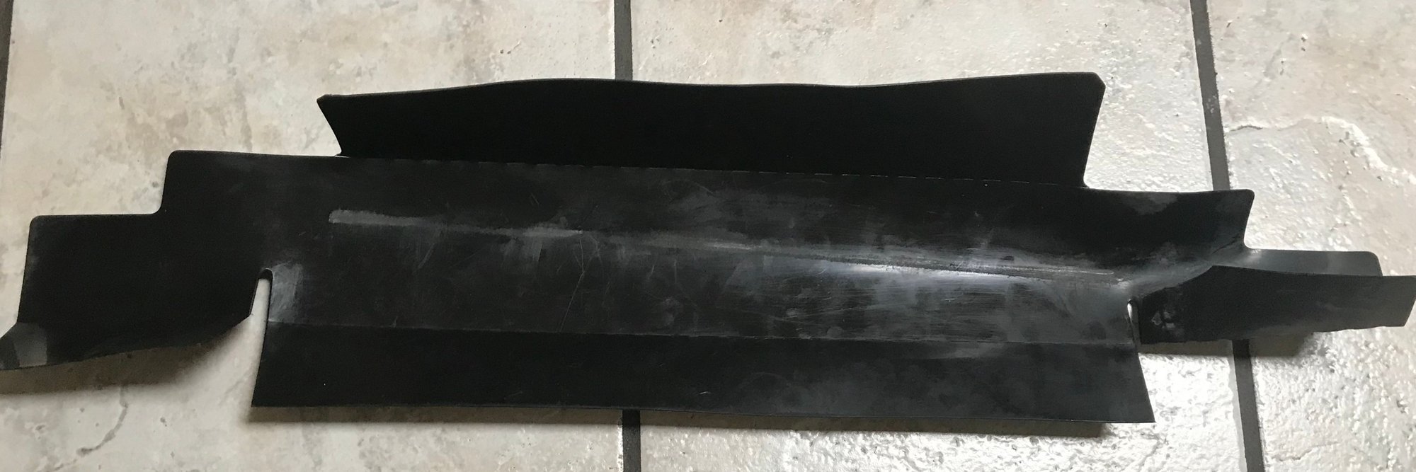

Hi everyone
It has been awhile since I have had to ask anything on here.
i replaced my radiator and forgot where this of plastic goes.
Thanks����

its a splash shield to keep water from getting splashed up into the air intake.

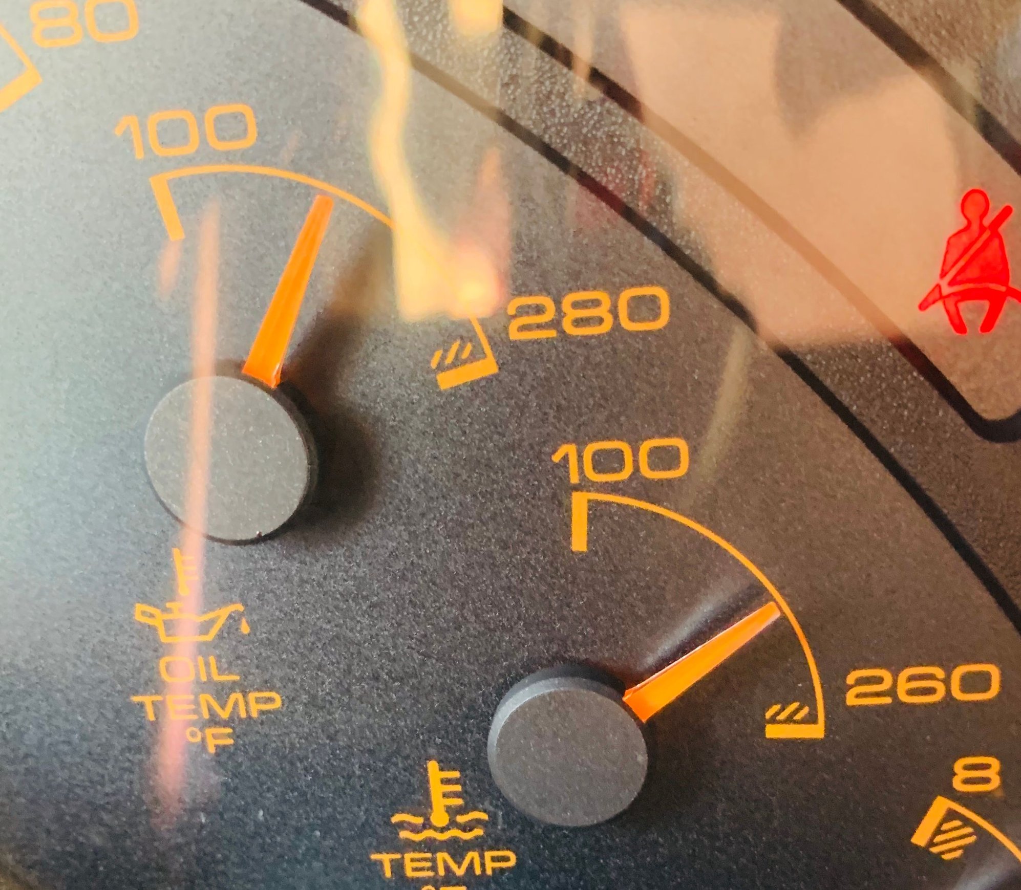

Today it ran 160 degrees. I left it sitting with a/c on for about 10 minutes. Same temp. The temp around Sun City was about 99 today.

I did put this piece back. There is a open space of about 3 or 4 inches under the condenser and radiator. It makes the air go thru and not under the two.

Been driving Her daily in the Arizona heat. Staying at about thermostat temp. I let it sit in the drive for 30 minutes at 105 and stayed the same. I am going to take pictures of the temp gauge during the end of July and August..

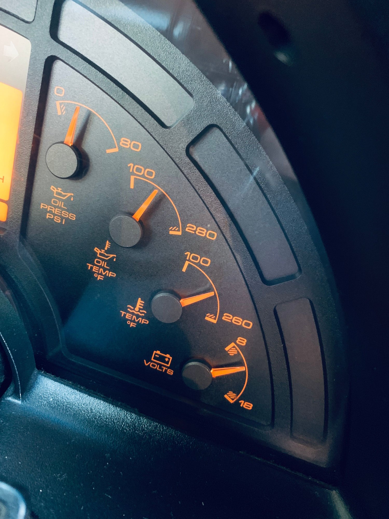

8
Driving Her daily in hot Arizona🌞. Temp staying at thermostat temp.
even while sitting in a parking lot running with Mom for 30 minutes👍🏼

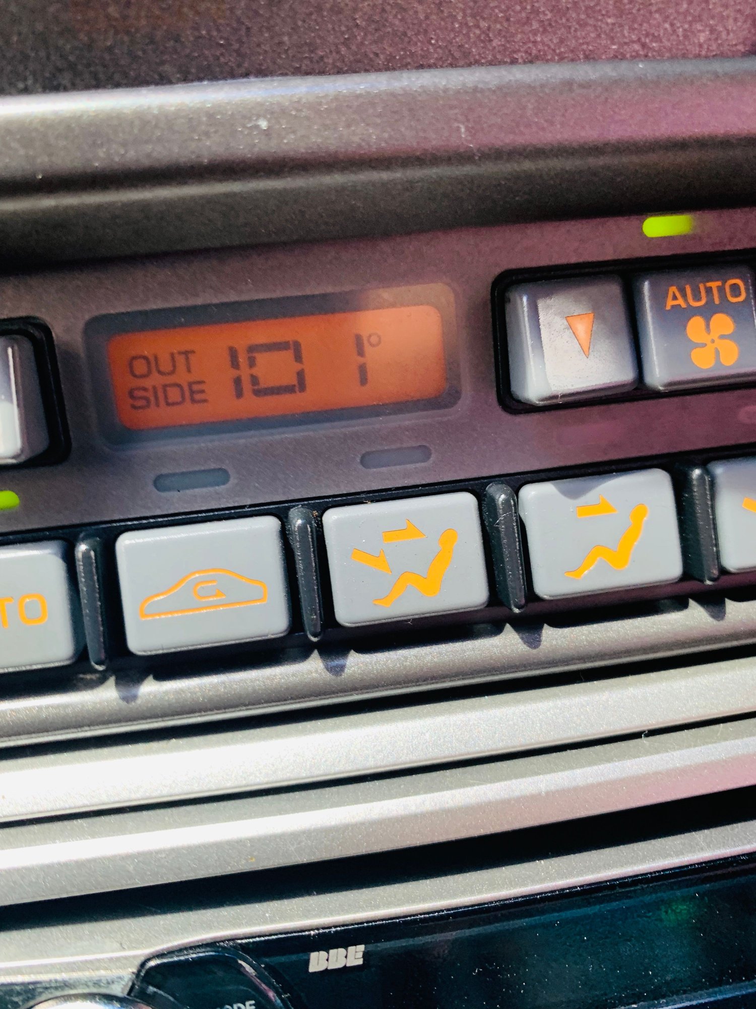

August 14, temps
i drive 10+ miles daily

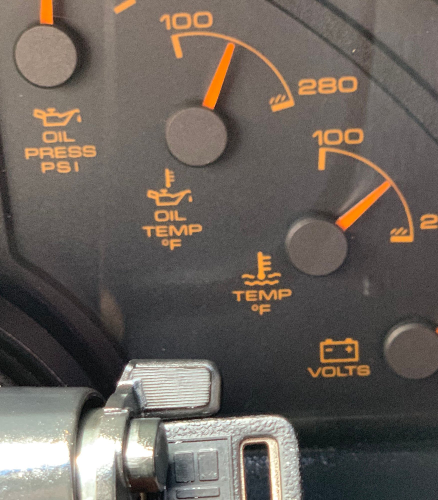

I had to replace the a/c condenser. It was a job getting in there. The original radiator was still working but always ran on the hot side.
this one fit perfect and looked like the original. I am very pleased. I drive it daily to the gym which is part freeway and backroads. Was 120 degrees on car this week and temp stayed at thermostat temp. Even sitting at the lights on the back roads. I think I took a picture.
