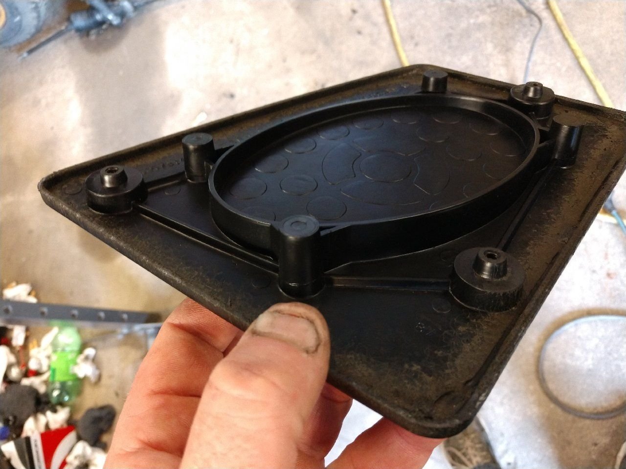

Here is a pic showing my door handle insert with the Tweeter Mount already in it. It's nice and small and doesn't look too big. Now of course with all of these interior parts I need to stuff them with a Scotch-Brite pad and then I will be spraying everything with sem Landau black color coat and everything will look brand new.
