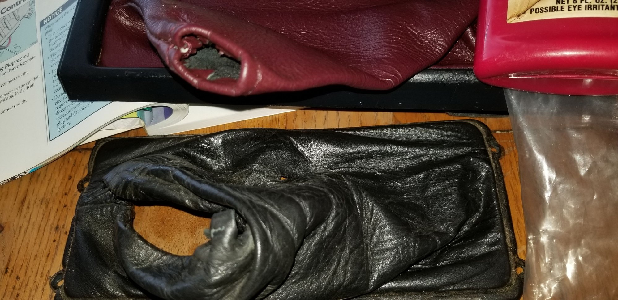

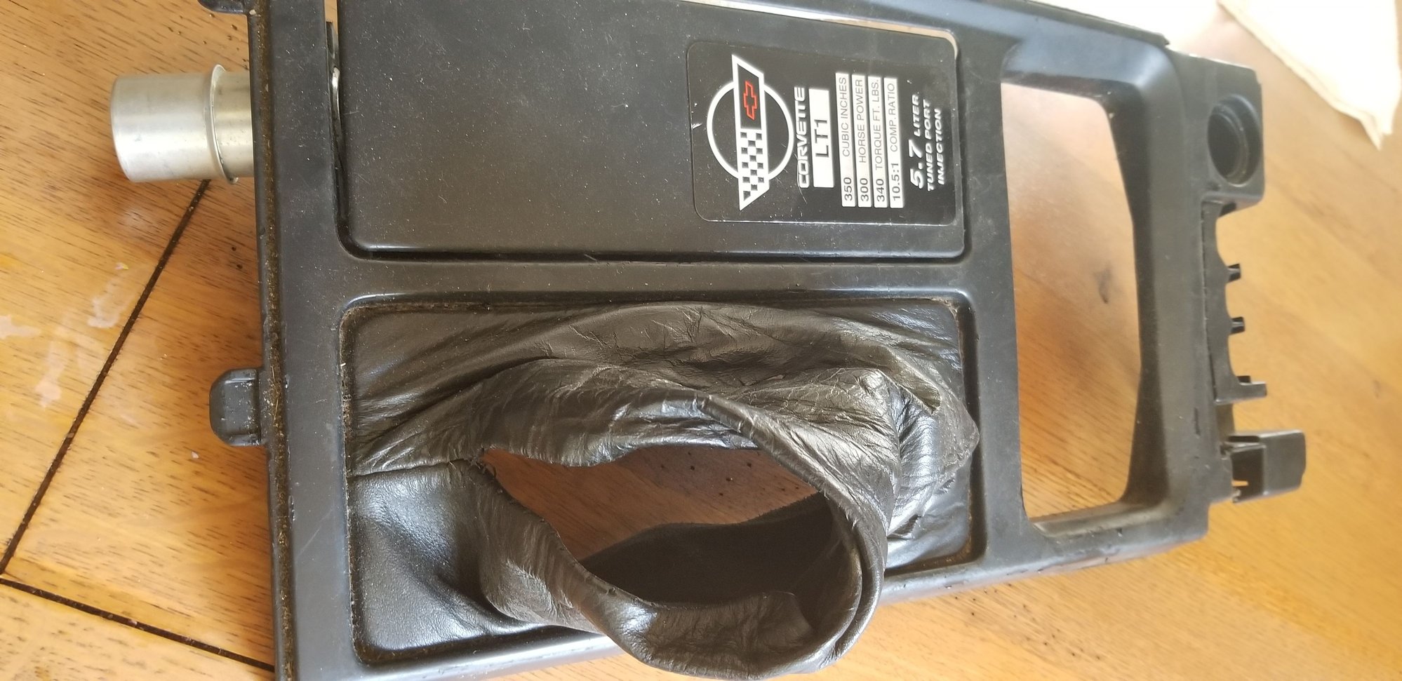

Got cover off to replace boot that had been cut at seam when the neighbor took out engine and tranmission a few years ago. Guess he didn't know how to remove shifter **** on 6 spd. After getting cover off everything is sticky and very dirty.

Found my new boot along with rear hatch extension, carpet covers for the speakers.
Used some leather care on new boot that really soaked in. Much softer.
Will need to clean the rest of the console before reasembly. Getting that set screw out may be dificult. I can't really see it, but assume it is a small allen head. Hopefully won't have to drill it out for a larger one!!
