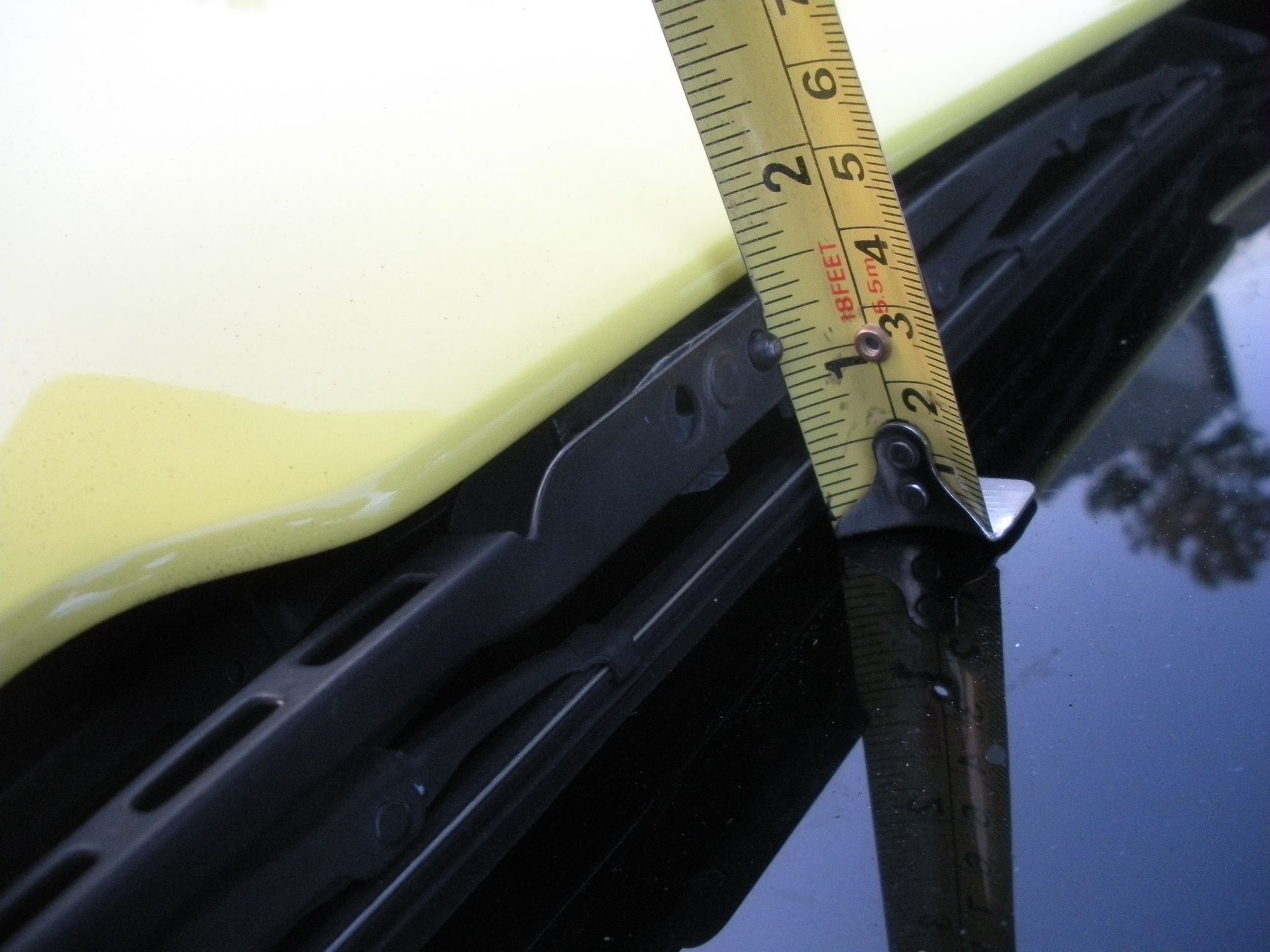

You could adjust hood bumpers and latch strikers. Oorrr try different wiper blades. Trico and ANCO were GM suppliers.

What wiper blades have you been using? The recommended blades for the '93 are the ACDelco 8-2202 (82202) or the Trico 20-2. I've found the Michelin "High Performance 20" to fit fine. As mentioned, your hood height can be adjusted if necessary.
