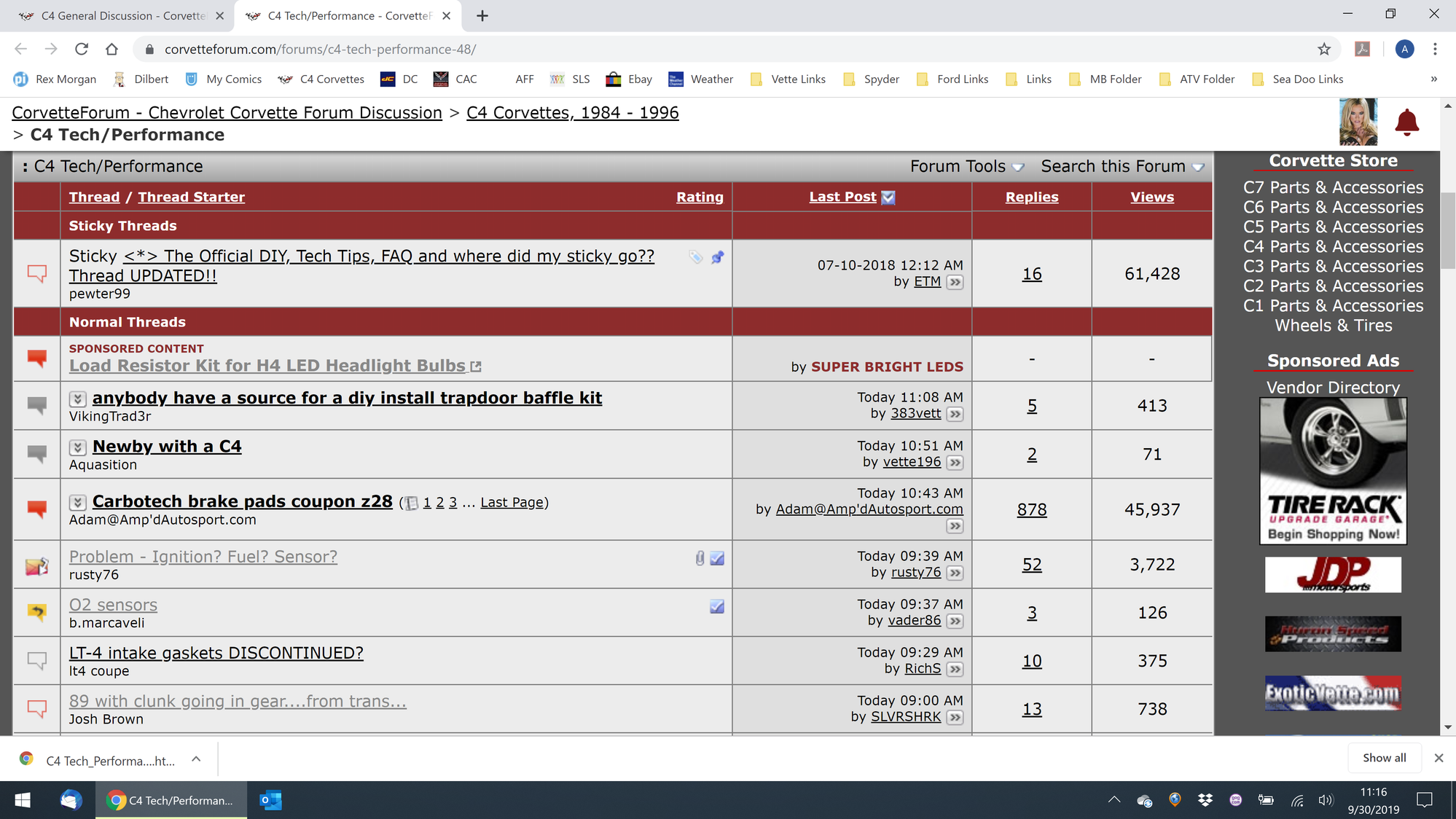

Speak of the devil. He could find it under "Sponsored Content". Wow!!
