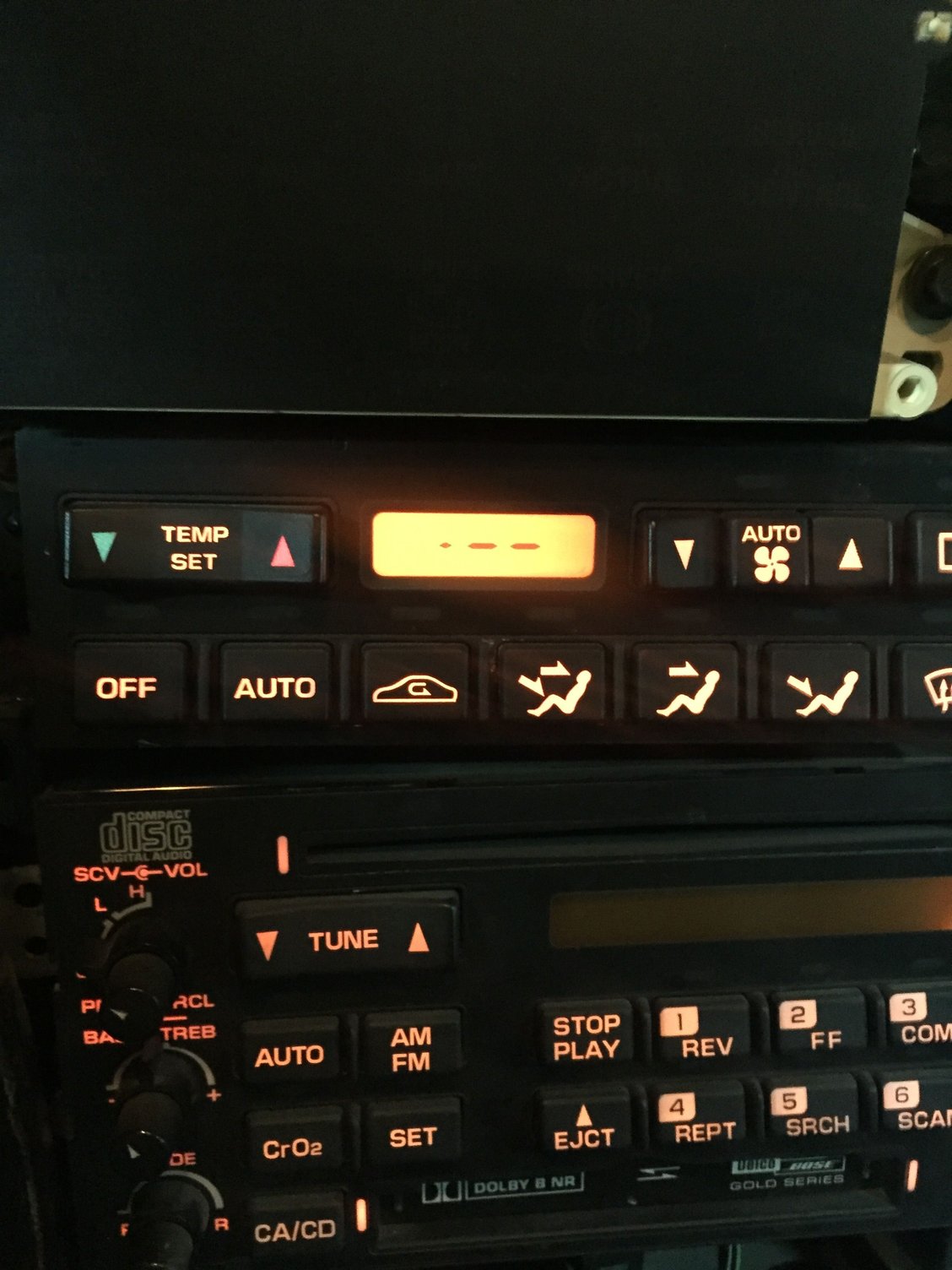

the car entered a garage for paint
and after finishing
once the car is turned on ...the ac works with maximum power and only for the bottom part
and all climate control not work ....i change it with my other 1994 vette but still same

Check the HVAC error codes on the display. Push the Up and Down arrows at the same time then press the Auto button. If there are faults stored, codes will be displayed on the LCD panel of the control unit.

I could not figure out the code

If i remember correctly from doing mine .. That is a code for for a bus communication error between programmer and control head. As said before .. Try checking batt cables .. On mine ,,i disconnected batt for 10 min with fuse out .. Put fuse in,,reconnected batt and all good

Default i do that...but still not working
