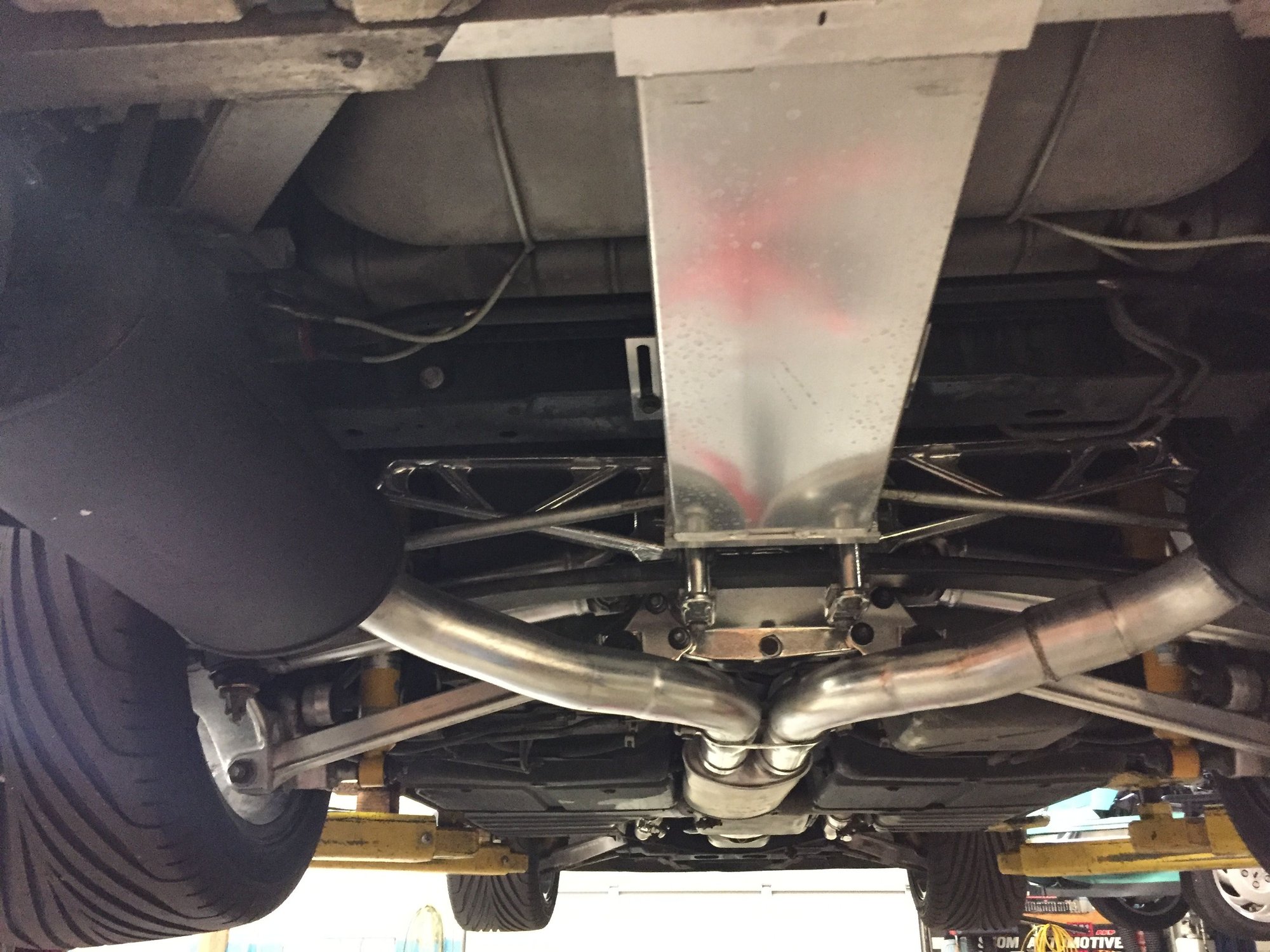

I removed the spare tire and carrier on my 95 years ago and replaced it with the spare tire "delete" "brace". Basically an elongated aluminum box that is a bolt-on. You can see it more clearly in the first pic and see how it runs under the fuel tank. When things are cleaned up in the back you can just see it .... if you are driving behind my car.
