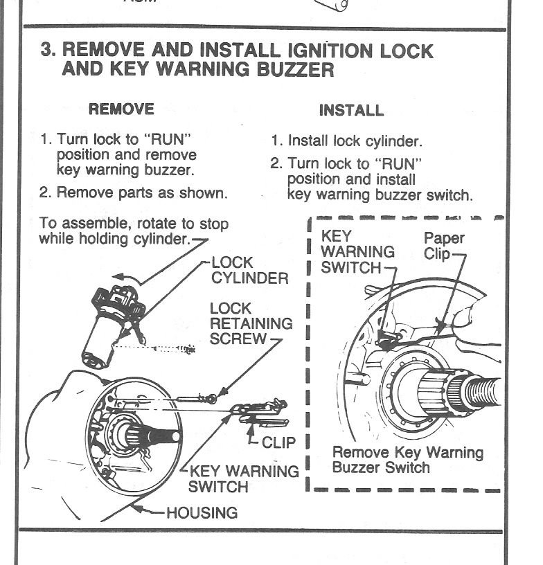

Is there a way to get the ignition lock assembly out of the steering column without having the correct key for the lock cylinder?

No. I'm thinking about the last two times I've disassembled my '84 column, and the last time I disassembled a '94 Pontiac column, and what's shown in my FSM:

Bought a 1985 Fiero from a junkyard over 20 years ago. Pretty sure it did not have keys. The lock cylinder came out easily after possibly destroying the key buzzer and removing the screw. Wasn’t difficult, I just remember that I couldn’t get the buzzer to work again. Maybe that’s why it needs to be in the run position?
