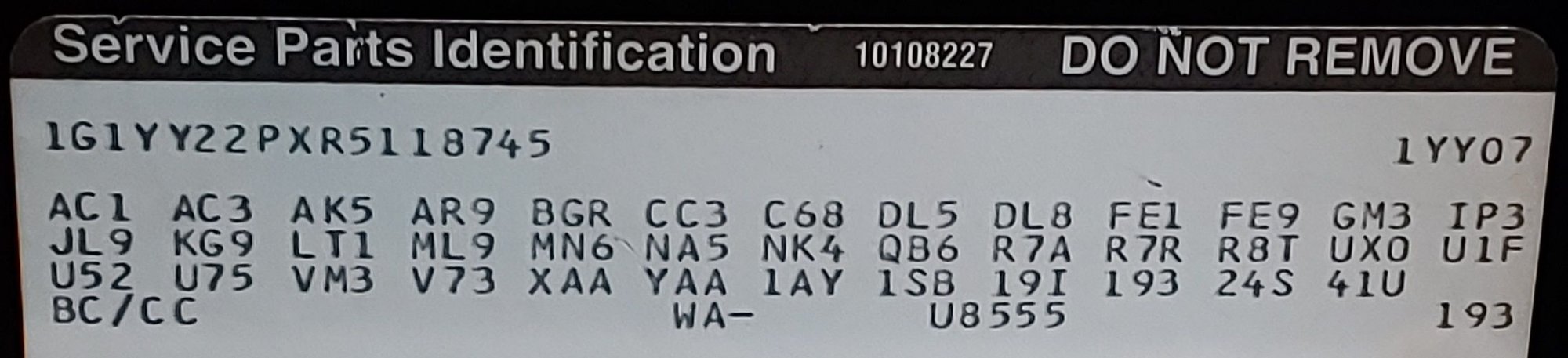

Found it, under the center console lid. However I see different codes online to select.. like 41/WA8555, WA8555, 8555, L8555, or U8555... wondering if those are all equivalent, or which number is the most important to match. I have a '94 Black base model.
Thanks!
Old Jul 15, 2020 | 07:44 PM
VADvette's Avatar
VADvette
Cruising
Joined: Jul 2020
Posts: 11
From: Wisconsin
based on another thread, it look like 41U indicates it a black upper coat color (and no lower code, otherwise it would also have a code with nnL, earlier C4s apparently had two tones).. so I'm still wondering what the 8555 is ..

According to my corvette book, the 95 vette with Dark Purple and White is paint code 05/10. 05 being Dark Purple and 10 being Arctic white. They only made 527 vettes that color combo and it appears that it was a vert with a white top. It also appears that if you do not have a vert, the colors are still the same paint code for a Dark Purple and White. The book also shows a RPO Z4Z code for the verts in DP/W color, but verts only. I do not see the U8555 listed, sorry. Hope this helps a little more.

U8555 means Black exterior. Does anyone know what WA stands for? I have a '95 Coupe.
