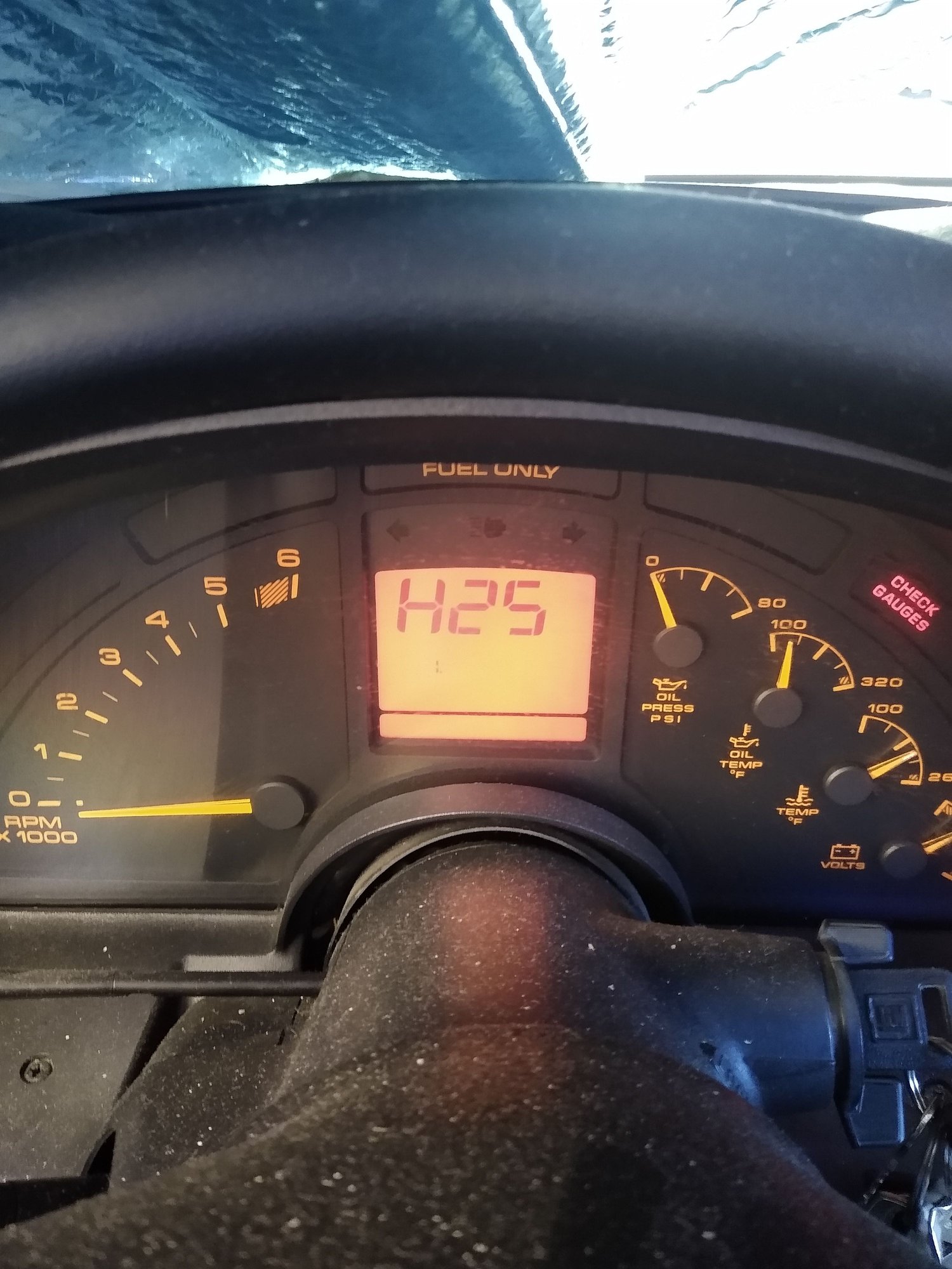

I pulled codes today and got 3. 2 had an h-prefix and 1 had a c-prefix. Is there a difference between the 2? I'm speculating that h codes are historic possibly?
Also what do this codes mean and how can I fix the issues at hand? Car is a 92 coupe with an at.

Dome light? Does this refer to the light on the rearview mirror? (I would call that a map light rather than a dome light personally).
I replaced my EGR valve recently. It went from a c code to an h code. I cleared the codes after that. I guess I should try the disconnect the battery trick to clear even the historic codes.
Now who at gm thought they should make a system were a minor electrical issue with an interior light makes a light on the dash that says "service engine soon" illuminate was a good idea?

C is current code - malfunction is present now
H is history code - sometime in the last 40 key cycles a malfunction occurred.
Modules will self clear codes if malfunction doesn't reoccur after so many key cycles.

I've never seen "SYS" flash in the odometer before. But I have had the service engine soon light illuminate before? But I don't have any engine codes?
