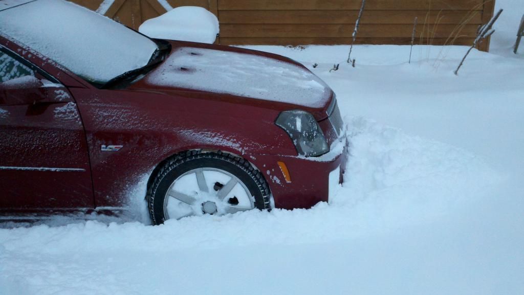

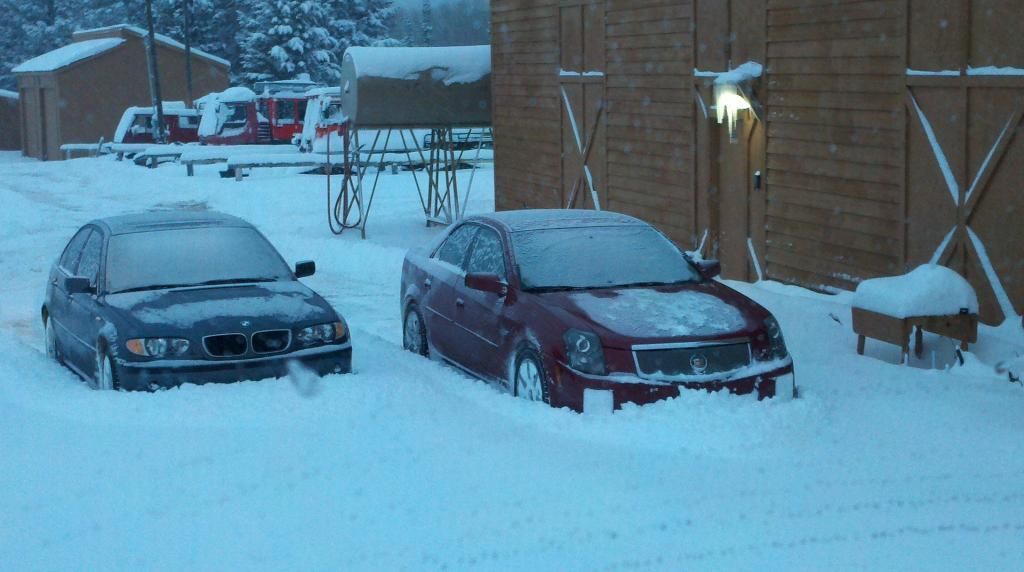

Any brand name 100% "SNOW" tire (not an "M&S" tire).
Something is amiss there^^. I drove Trans Ams around for years, in New England winters. I'll be honest....I didn't even put winter tires on the things. My wife and I drove a Cadillac CTS-V for year, here in Park City and Telluride. That car was shod with Hankook Ice Claw (?) tires and later, Nokian Hakkipalitta (sp?) tires. In all examples, I've driven TA's and the Caddy in snow deep enough that the front of the car was plowing snow. No issues.
Originally Posted by drcook
Its not that dry cold winter days that are the problem. Its the snow days.
It's the mind-set and/or equipment that's the problem, not the snow. If you have decent (real snow) tires, and the right attitude, it's totally doable. If your Mustangs and Camaros were spinning out of control at low speeds on snowy roads....you had the wrong tires, regardless of width.
No problem there^.
Additional data point: IDK if he still lives here or not, but for a few years, back in the '00's, Cheech Marin lived here in PC. He daily drove a black Lamborghini Diablo, year round....I'd see it all them time. Dry, snow, whatever. PC gets ~350"/year of snow and those cars have wide tires.
