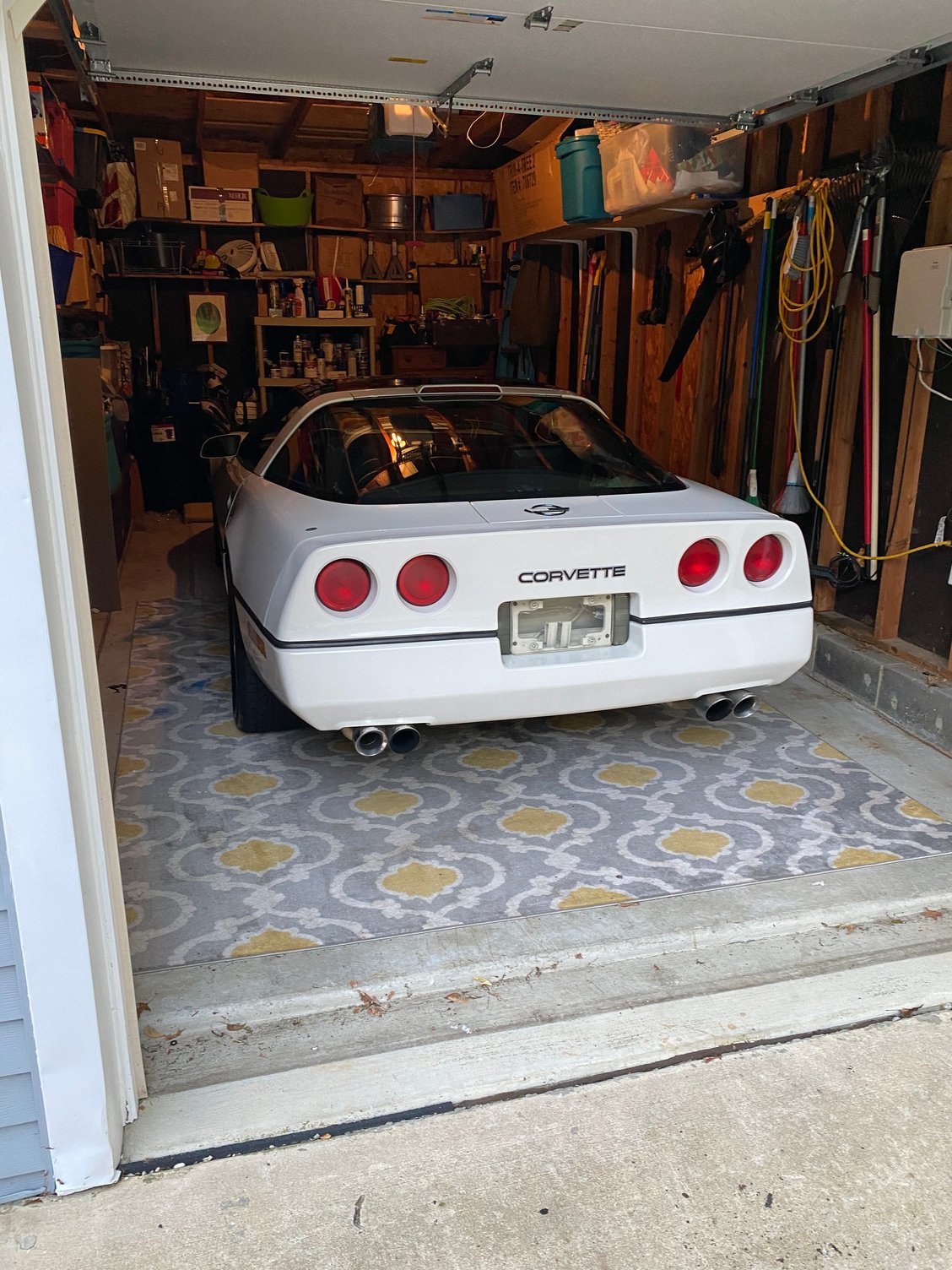

This will be the first winter I own my 86 corvette and am looking for advice on putting it up for the season
Other than a battery tender and some fuel stabilizer are there any other recommendations? The car will be in a garage, unheated. Should I pull the wheels so they don’t develop flat spots ?

You should change out the ugly carpet

What is that carpet for?
sure is. That is why it is in the garage. LOL
