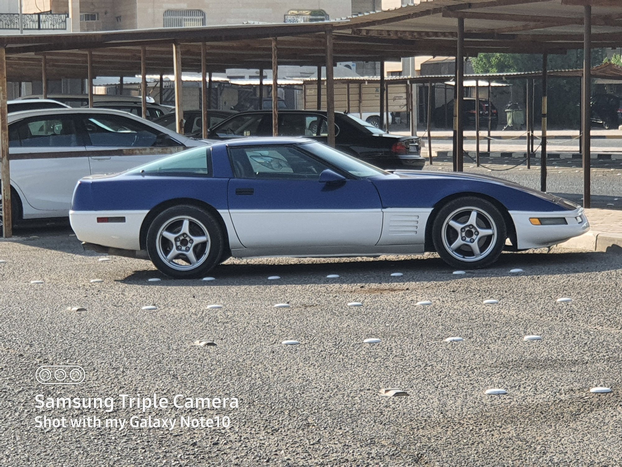

Hi everyone 😊
i hope you can help me my friends.
My father just gave me his old C4 corvette because I always want to own one, i can't tell you how happy I am now.But there's one problem the car star fin and the idle is also fine, but as soon i hit the gas ... the car start chokeing and shutdown. I called almost all workhops in the area but they told me no one now works on old corvette Specially the C4 it's so complicated ....even some of the workshops called it an old relic 😥. so I decided to fix it myself.I just need some one to guide me .....i just want to know where to start.
P.s i already installed a new battery & a new spark plugs but its still the same.Thanks my friend 🌹

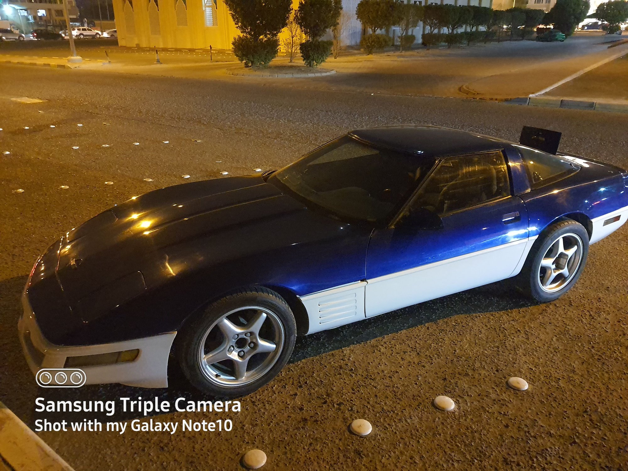

it was originally blue with white line on the hood just like the grand sport corvette, but my father repaint it years ago.
i think he once said he was inspired by the corvette from the 80s American tv show ( A-Team) 😊 but he wants to keep the original colour... the blue and white, so we got this 😊
