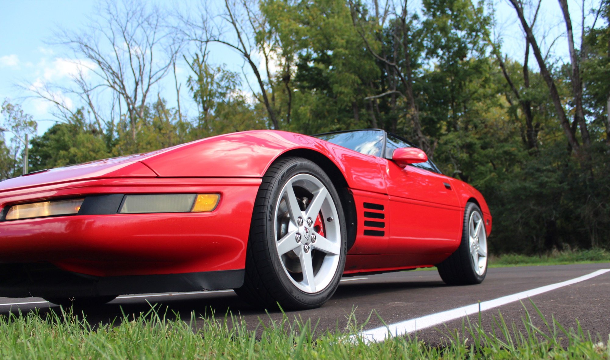

Yes, but you may need wheel-adapters depending on what size wheels you put on. My 94, has 2006, 5-spokes with 1.25" adapters on the backs. (F-18s/R-19s) The fronts fit fine with no modifications.
I'm not sure, but I think if you use 4 "front" wheels from a C6, you don't need any adapters at all.
