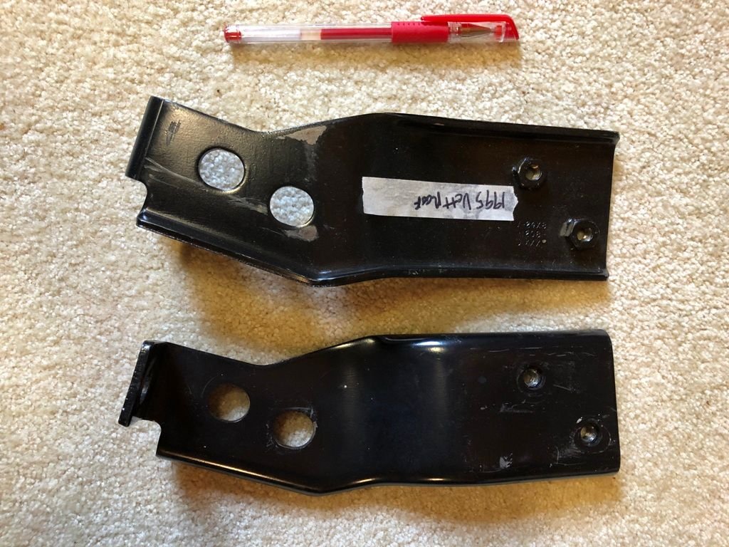

Here is a picture of the brackets from a 1995 C4 convertible.
You will also need the 4 torx bolts.
The brackets attached one on each side, just behind the seats.
I think the NUT side attaches to the Roof, and the oval-ed holes attache to bolts in the cars body.

There are actually 5 bolts that are needed per side for those brackets. In addition to the 2 per side that attach to the top and the 2 that go through the holes in the bracket to the car body there is another that anchors the tab that is at 90 degrees at the bottom of the bracket to the body of the car. It is mounted that way so it forms a rollbar of sorts when the hardtop is in place. There is a very specific sequence to follow when attaching the top to the car. Additionally there are long bolts that go through where the mounting lugs for the soft top mounts to the deck lid.
The brackets are readily available from ZIP Corvettes and others but are about $100.
