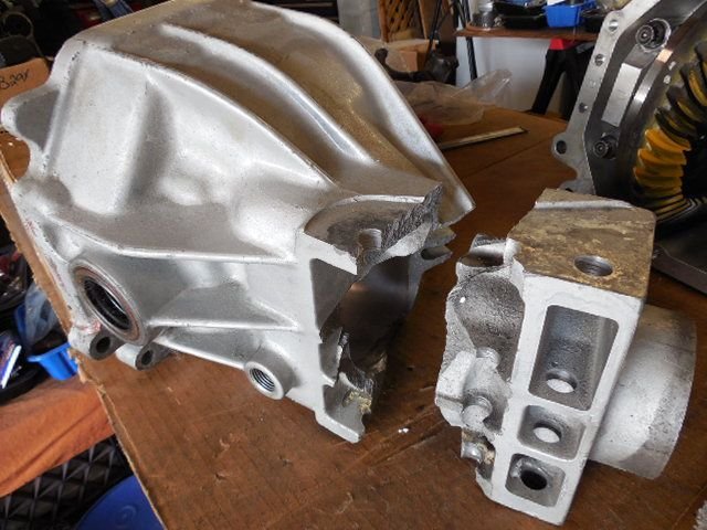

I just broke the nose off my Dana 44 and cracked the carrier in half about an hour ago. When I get the car home and in the air I will take some pictures of the destruction I've caused.

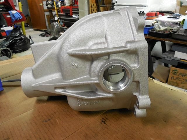

..... Pull it out batwing and all ... I feel your pain , did this about 7 or 8 years ago on a trans brake launch that involved a faulty 2-step .....
..... This was my motivation to buy a Newman Car Creations Housing .....

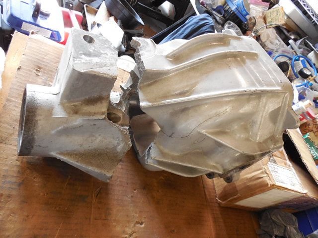

Well.. what happened was 305/45 17 Mickey Thompsons and a 4500rpm hole shot.. thats all.
As soon as I dumped the clutch, there was no bang, no loud noise.. just nothing as if the driveshaft was totally disengaged. The pinon gear attempted to climb the ring gear and just tore the entire nose off the diff. Crawled under the car w the phone and this was the sight:

I saw that newman housing, looks noice! but spensive.
