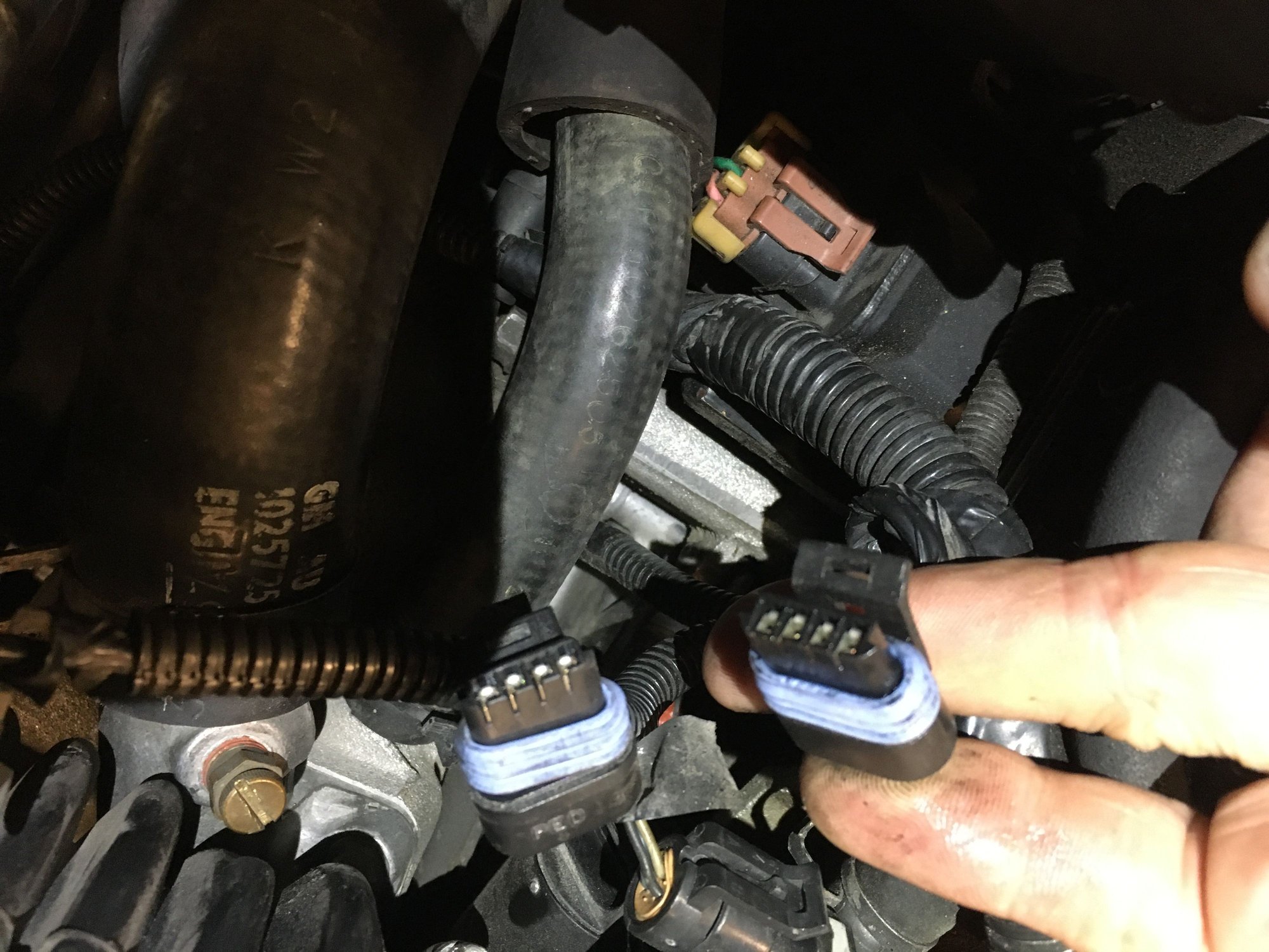

Here’s a possibility, especially if the wiring harness tape and tubing is unraveling at all in that area. The harness plugs that fit the ICM and IAC are the same and can be mistakenly plugged into the other. Make sure that the harness plug with the pink wire is plugged into the ICM. I made this error myself recant it caused the symptoms you describe. Here are the two identical plugs which you can see are in the same general proximity.
