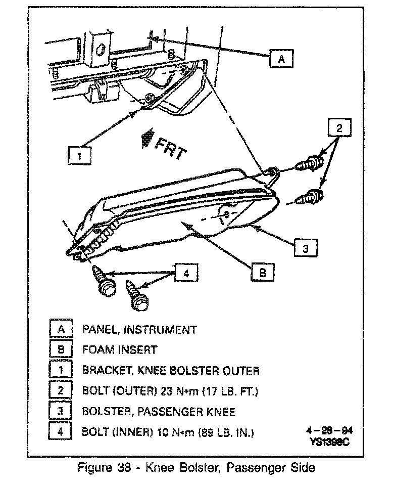

I just tried, got as far as getting the end plate off and the lower dash on the outboard end is free. I can't find any screws/fasteners anywhere else. it seems there is on bolt holding the lower panel up and I can't find it. I'm afraid to start pulling stuff out for fear of breakage. I'm sure it's an easy trick once you know it.
But I don't and I'm stuck.
Old Jan 31, 2022 | 06:24 PM
WVZR-1's Avatar
WVZR-1
Joined: Sep 2003
Posts: 25,414
Likes: 2,745
I don't know if the Right Side Knee 'bolster' requires removal to access the relay cover & box but if yes here's an image of it,

Vette 460's Avatar
Vette 460
Joined: Oct 2021
Posts: 258
Likes: 27
From: NY
That helps a lot. I think I can do it now and I'll let you know how I do.
