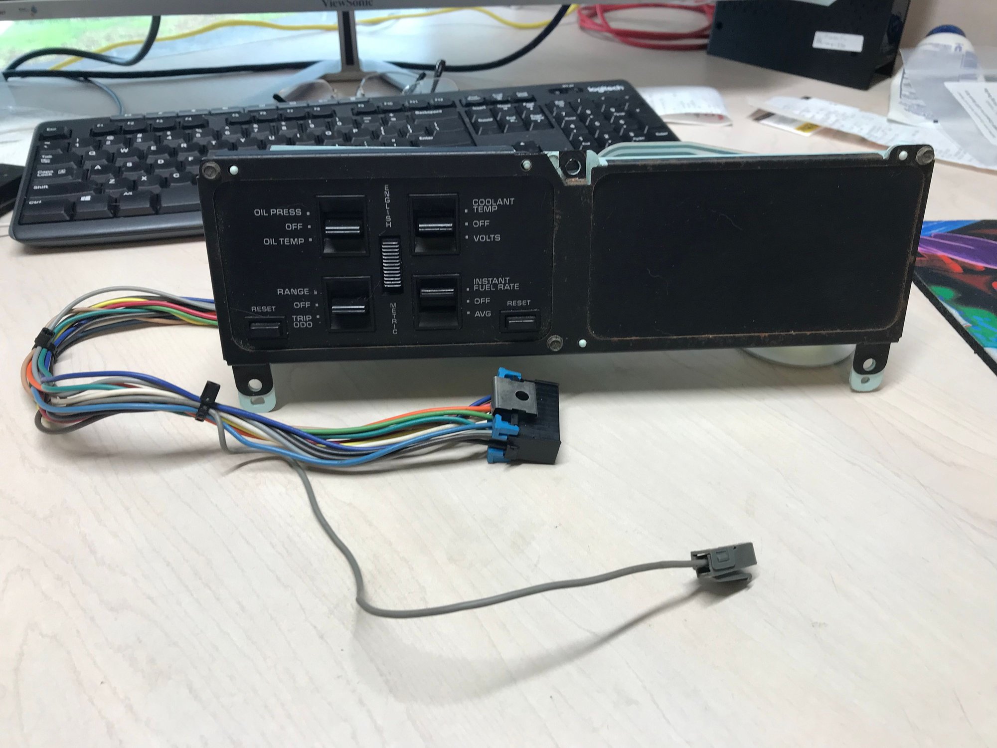

1987 C4 coupe: From the information center is a wire harness that plugs into the dash instrument panel except for one, grey wire. (as shown in photo). Where does that wire plug in/go to? It pulled out from behind the radio area but I can not find any ‘other end’ for this to plug into. I tried the FSM wire diagrams but that got me nowhere, just boggled my alleged mind. If someone could point me in the right direction I would appreciate it. Thank you.

If you don't have C68 ATC don't worry about it. Do you have C68?
There's several threads regarding it
Here's 1
https://www.corvetteforum.com/forums...d-i-c-pic.html
That wire is for the English/Metric Switch output for a car W/C68
In your FSM & if you have C68 the wiring diagram 8A-68-0 will help.

its for the climate electronics
