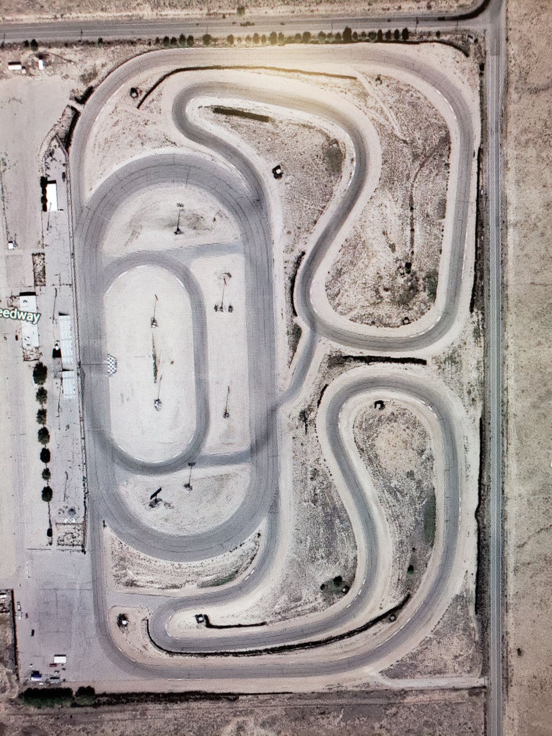

questions: how long is your course, how many turns, whats a typical lap time.

2.7km course, 1.67 miles
Course record is 1:29.511
My personal best is 140.944
8 "normal turns"
2 double Apex turns
2 hair pins
2 straights
Picture related. A single race day is 4 heats, each heat is 5 laps, of which 3 are hot, one is a warm up and one is a cool down. So the three hot laps generally end up being about 5 minutes total?
Like I said I don't think I want this 89 to be a dedicated race car... I like it too much to put it through a tire wall. Long term plan is a 1996 LT4 as a nicer daily to also race sometimes, but a dedicated race C4 down the road.

Yeah, for just two more events I'd probably just do Motul 660 also. That track is pretty small and mostly lower speed, so it probably won't kill the brakes. My local track is sort of like that, too: just one hard-core braking zone. I'd defer to Viking's pad recommendations. If those Dynamic Friction pads endure heat as well as the Power Stop track pads but are nicer to the rotors, that should be a good option. Viking, no problems running these pads on the street, at least to get to and from the track?
