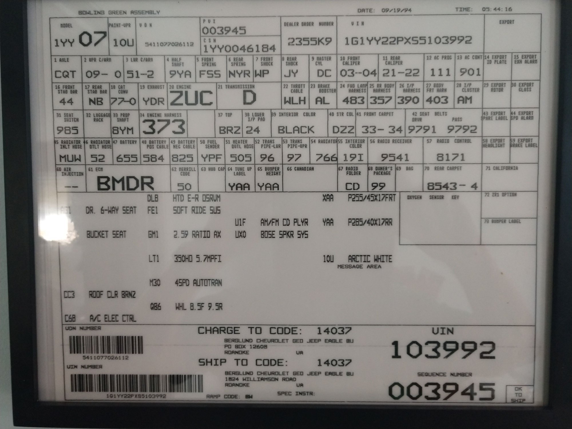

I have the Black Book and it does not have the information I am looking for on this car. 1995 Base/Coupe two Examples - Block 21 TRANSMISSION - Code is "D", Block 50 FUEL SENDER - Code YPF.
I can't find information on what those codes are telling me.
There are 73 blocks of information on this sheet and most have data, some are blank and some are easy to understand. From the Examples I have seen in other years it would seem that the layout, number of blocks and amount of information vary from year to year. .....The search goes on.
They do vary year to year Block 50 if a ZR-1 I'd expect YPE for '95, an LT1 in an Export car I'd expect YPG, YPF = LT1 non EXP. D in trans block maybe isn't odd. A ZR-1 in '95 has an R there. What's the 3 letter code in the block before the D? ZUC maybe? Is it an A4 or M6? If an M6 I'd expect maybe XHT or ZUF.
I mentioned earlier I believe - just post an image of your Build Sheet. The more legible the better.

OK, Attached is a photo of the Build Sheet as it hangs on the wall. (too big for my scanner) Hopefully, you can expand it enough to read it. If not I am willing to type the information in an effort to get it decoded/translated into useable information.

OP #1 - CQT is actually the 2.59 rear axle, 2 - 4 of no consequence/value to you except that your half shaft might have a label 9YA still there, you have FSS Front Spring, NYR Rear Spring, if shocks were original there might be a WP & JY label on them, ZUC engine is what I mentioned. Most other information was relevant to assembly line, block 37 BRNZ top, your steering column would have a label DZZ as well a a part #. I do understand nearly all but they're typically of no concern to most owners.
If your PCM were original it should have a label with the BMDR included on a label Also the Emissions label under-hood should/could have YAA as well as a part # on it.
