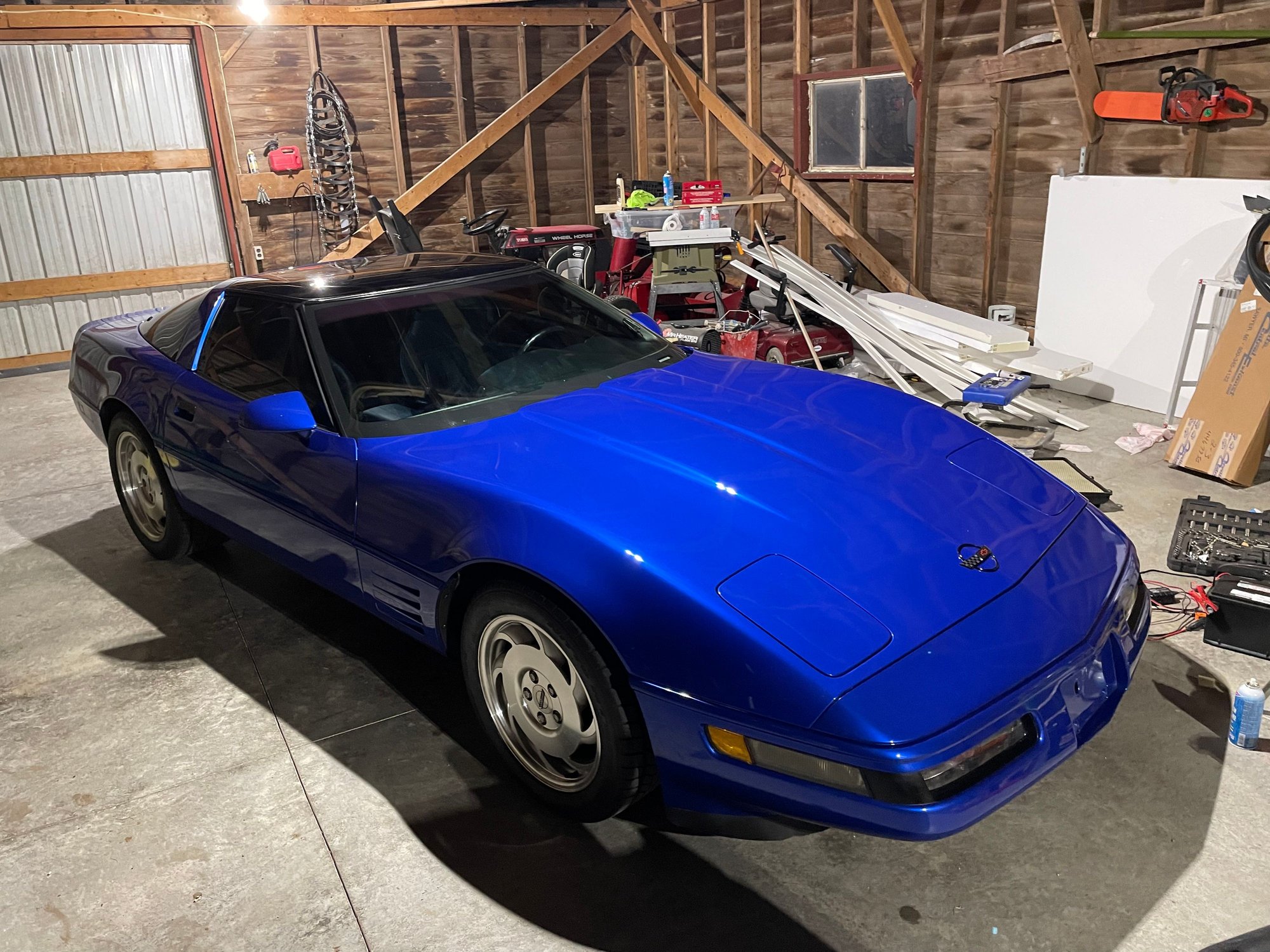

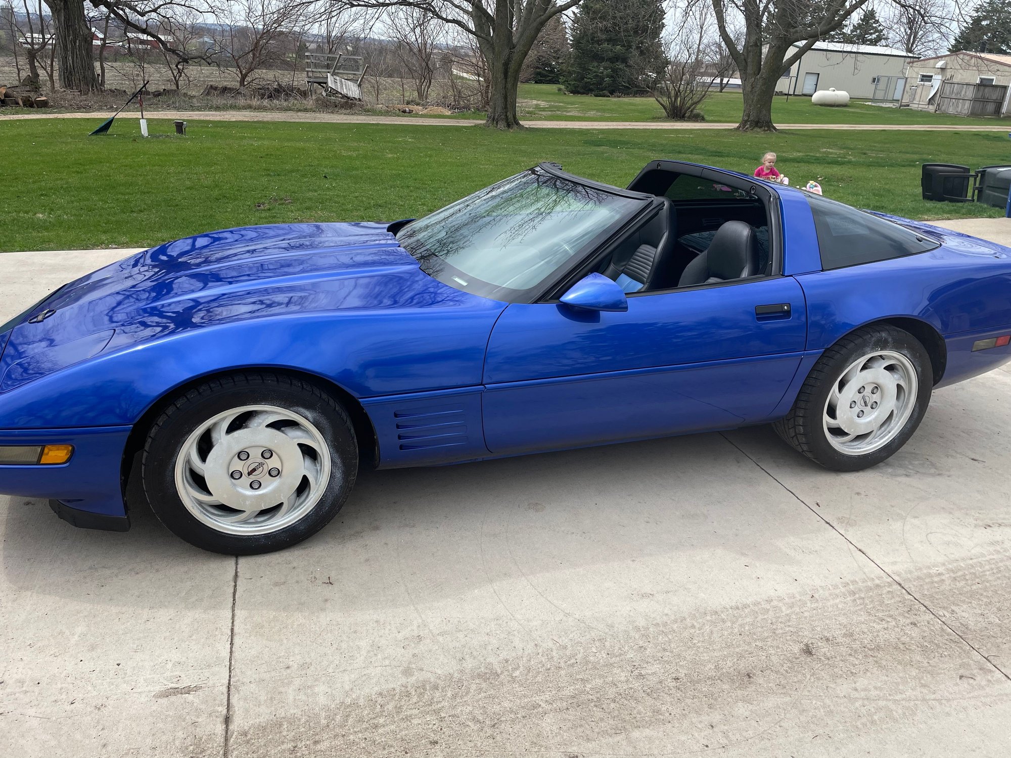

Bought my first c4. 94 with 50k. Had it for a month and it has been an absolute nightmare. Runs perfectly until it warms up and then will stall like the key has been shut off. Usually about 3-5 miles of driving or 10 min of idling. I Have been towed home twice now and that was enough. Dealer said “we put in a new fuel pump”, but unsure. I have put in a new ICM and battery so far. I believe it sat quite a bit the last 7 years.

Looks nice.
