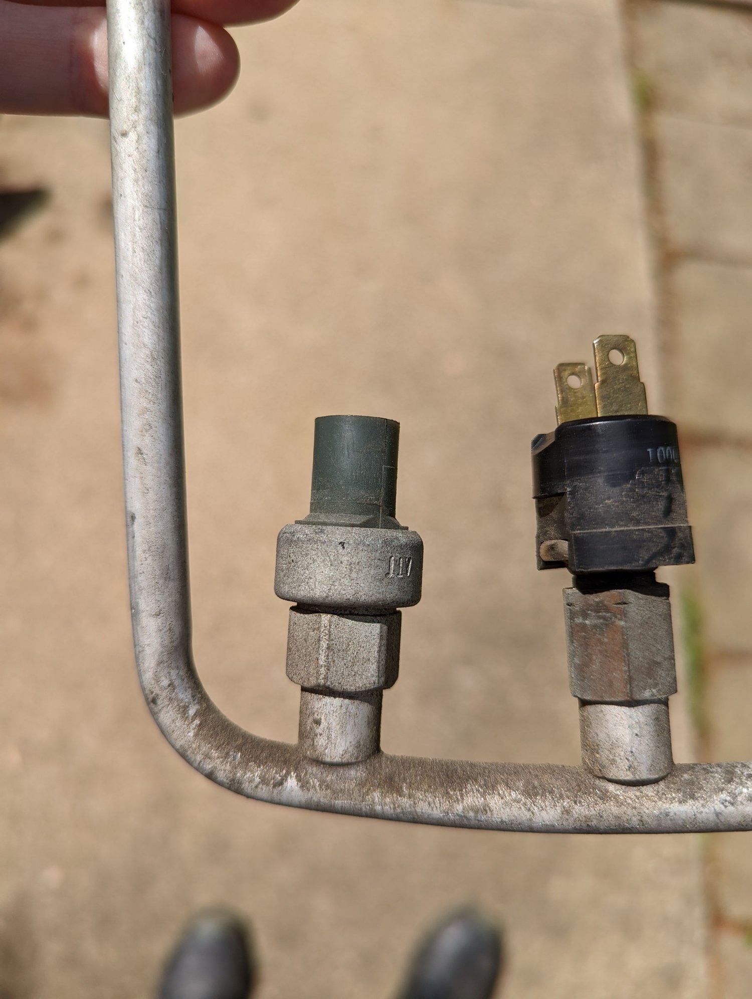

Got it all back together. Only strange thing now is the fan comes on right away. I replaced the coolant sensor on the front of the intake. Is there something else i need to mod with the A/C wiring... wondering if something with removing that stuff is triggering the fan?

fan inputs are coolant sensor, the AC presure switch on the freon liquid line or the fan relay is stuck closed, is the left fan staying on or the right, the right side will only run in hot weather with ac on. your fan operation wouldnt be affected buy A.I.R delete. you could disconnect fan relay and see if it stops running , relay is on the left side of the radiator. also the fan will run in diagnostic mode, ALDL pins A and B. if you need more info i will have to look at my manuals diagrams

you deleted ac. what did u do with the ac portion of the harness? it could be that the ac portion of the ecu is “seeing” high pressure.

The harness is still present, but the tubes and compressor are gone. I don't see how it could think there is any pressure.

I connected the harness back to the sensors. Looks like it's the little guy on the left...if I disconnect it the fan comes on, even though the tube is not connected to a pressurized system.
