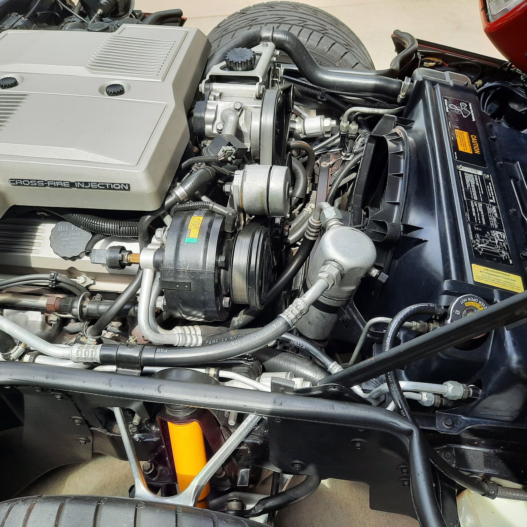

Need pics of the bracket locations on the engine block for my 84 so I can finish the rebuild....all my pics went when my phone crapped out

This is all I have right now but I can take more picture later

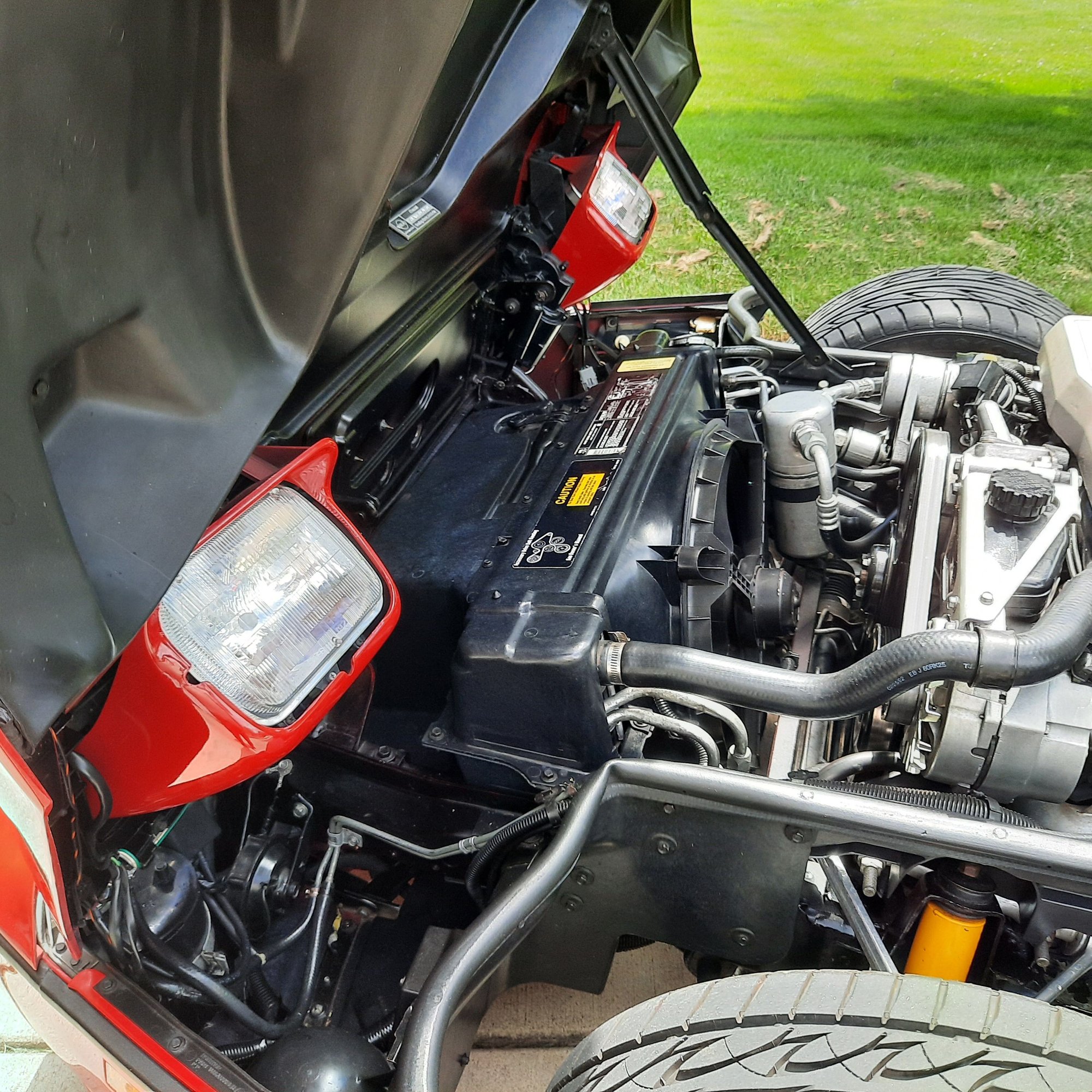

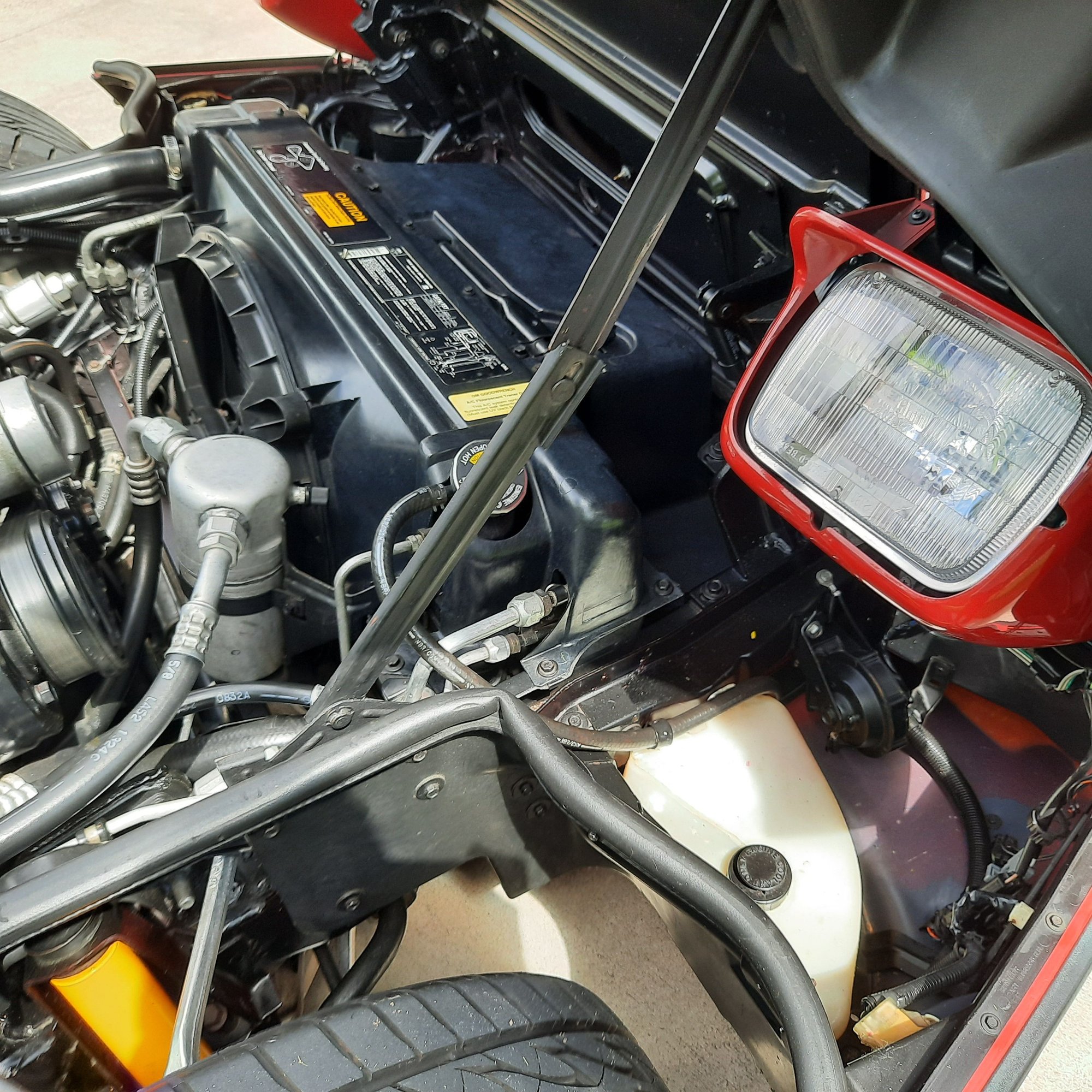

Default Attention L98 owners
This is what your engine and compartment should look like . Perfectly clean like it just rolled out of Bowling Green !!!! Well done my friend !! Solid A- plus grade !

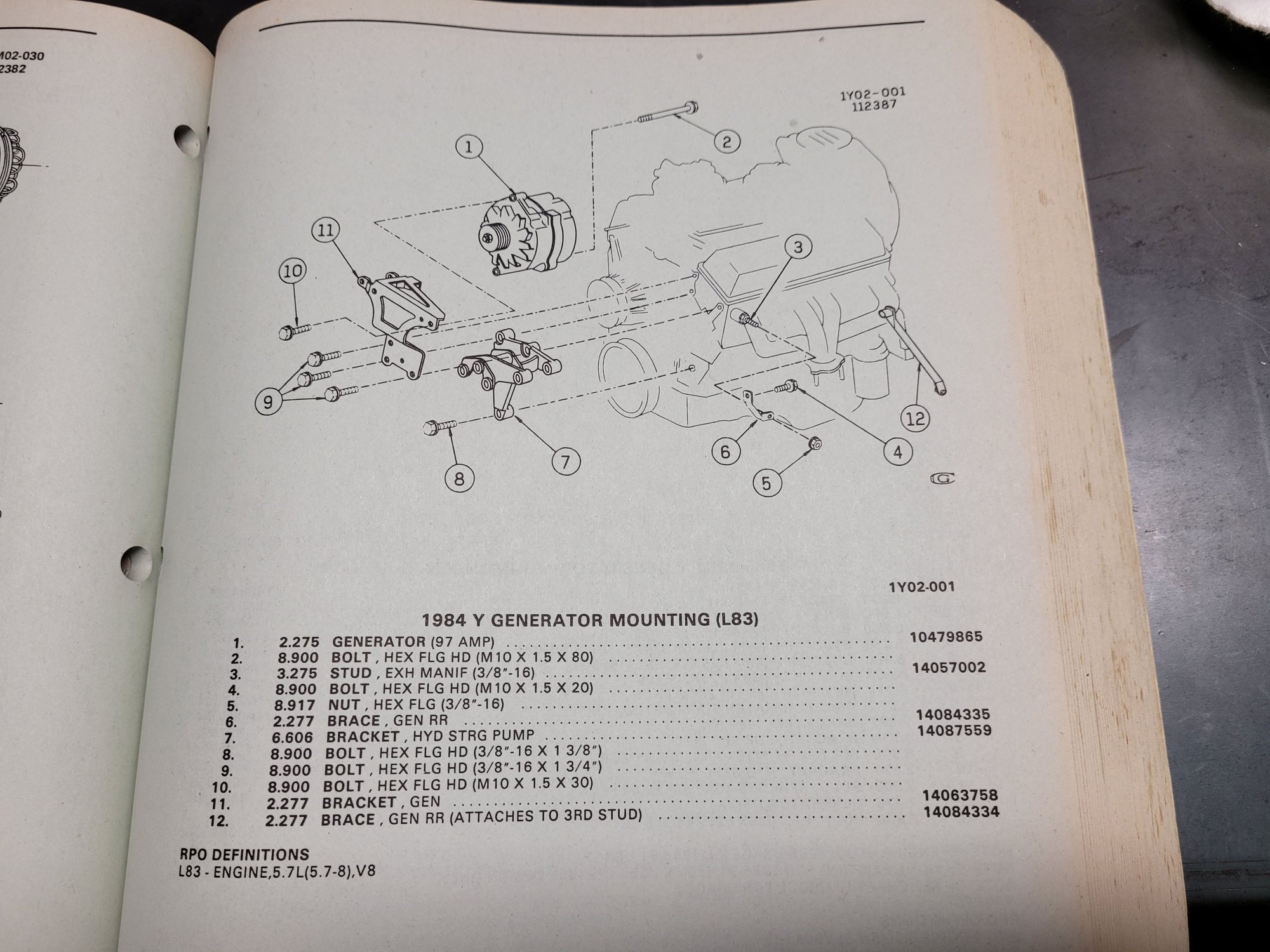

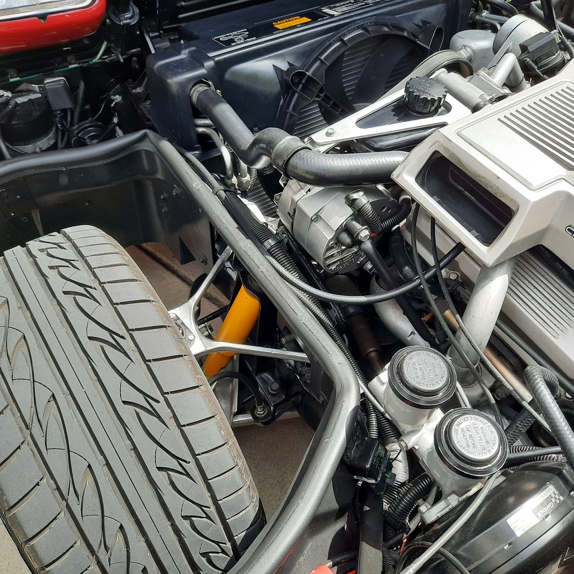

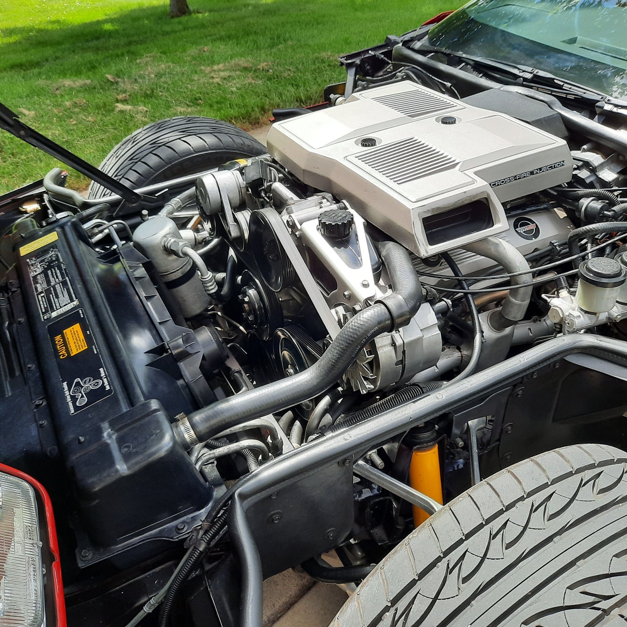

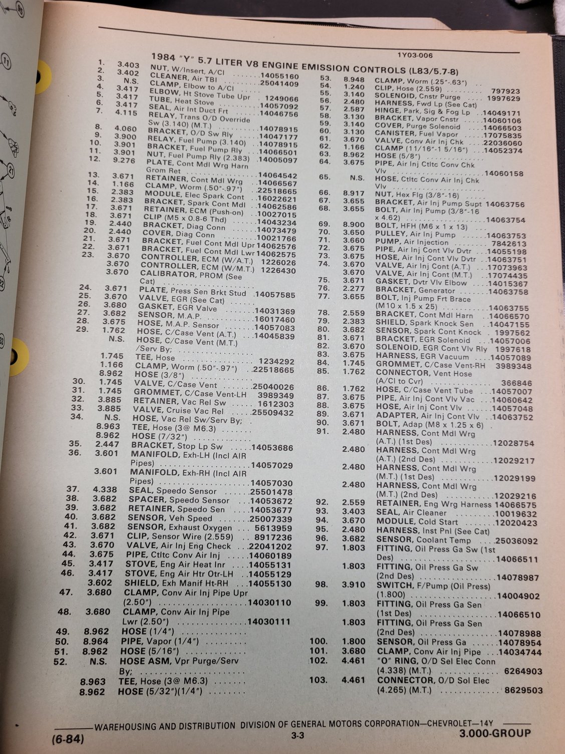

Here's some pictures! Went a little overboard, but wanted you to have plenty of references! Click on pics for better resolution and to zoom in! Hopefully this helps you out, good luck👍

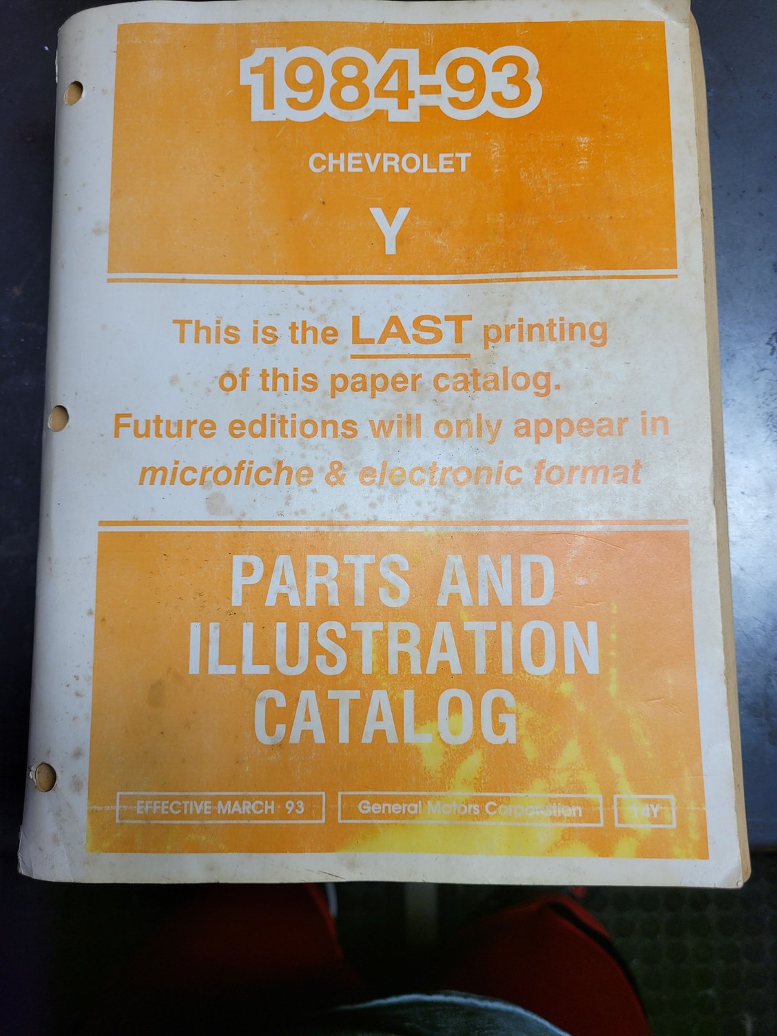

Thanks. What book are they from.... I'd like to get one
Most are from the 1984 GM Y-body "Parts and Illustration" catalog, a few are from the 1984-93 "Parts and Illustration" catalog. For the C4's, they started printing them in 1984, then each year after (until 1993, they went microfiche/electronic/digital after that) the catalog was updated to include the current year. So I have the original 1984 version and I also got the last paper version 1984-93. I like having the first printing of whatever year I have, it'll have original part numbers and I like that for researching and locating NOS parts, I also like having the last printing, it has more current part numbers and I like to see the differences between years and what they added/changed to see what can be added or updated on my '84. There's a 1984-85 Parts and Illustration Catalog in the C4 parts for sale section of this forum right now, forum member wants $59 shipped, which I feel is a decent price considering it's basically brand new. You can expect to pay between $35-$150, for these catalogs, it all depends on condition and how many years of C4's they cover👍
