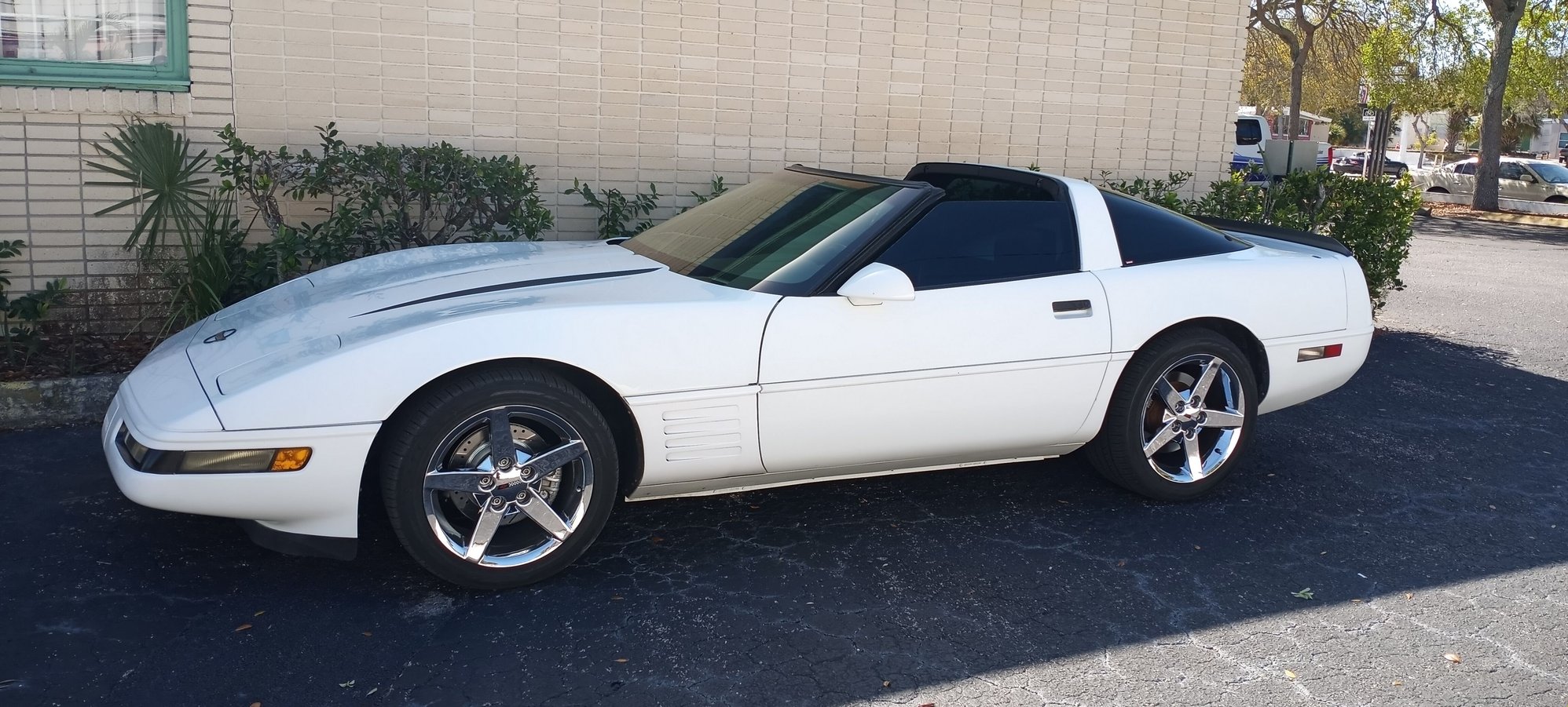

So I have a 1992 coupe, when I purchased the car it still had the original exhaust set up. First thing I did was have the stock mufflers replaced with Flow Master Super 10's. Although it sounds better, it really isn't that loud at all. I really thought the 10's would be louder. I'm not looking for it to be obnoxiously loud but I'd like more growl and sound from the exhaust when you hear it from outside the car. I'm also trying to avoid the dreaded droning at low or higher RPMs. etc..
Question is, should try removing the resonator or will that even make a difference. If I did, should I replace it with a X pipe or H pipe or just straight pipe? Will this increase the exhaust sound any? Any negatives to be thinking about?
Thanks for the replies!
