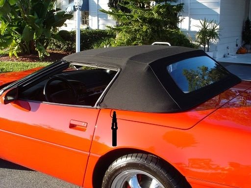

Just today the hood door for the convertible top to go under is now clicking open on it's own.
we found the fuse and it's ok disconnected the battery and the clicking stopped re connected battery and the clicking started again I assume there's
a relay somewhere in the car for this ? sorry title is wrong 1989
