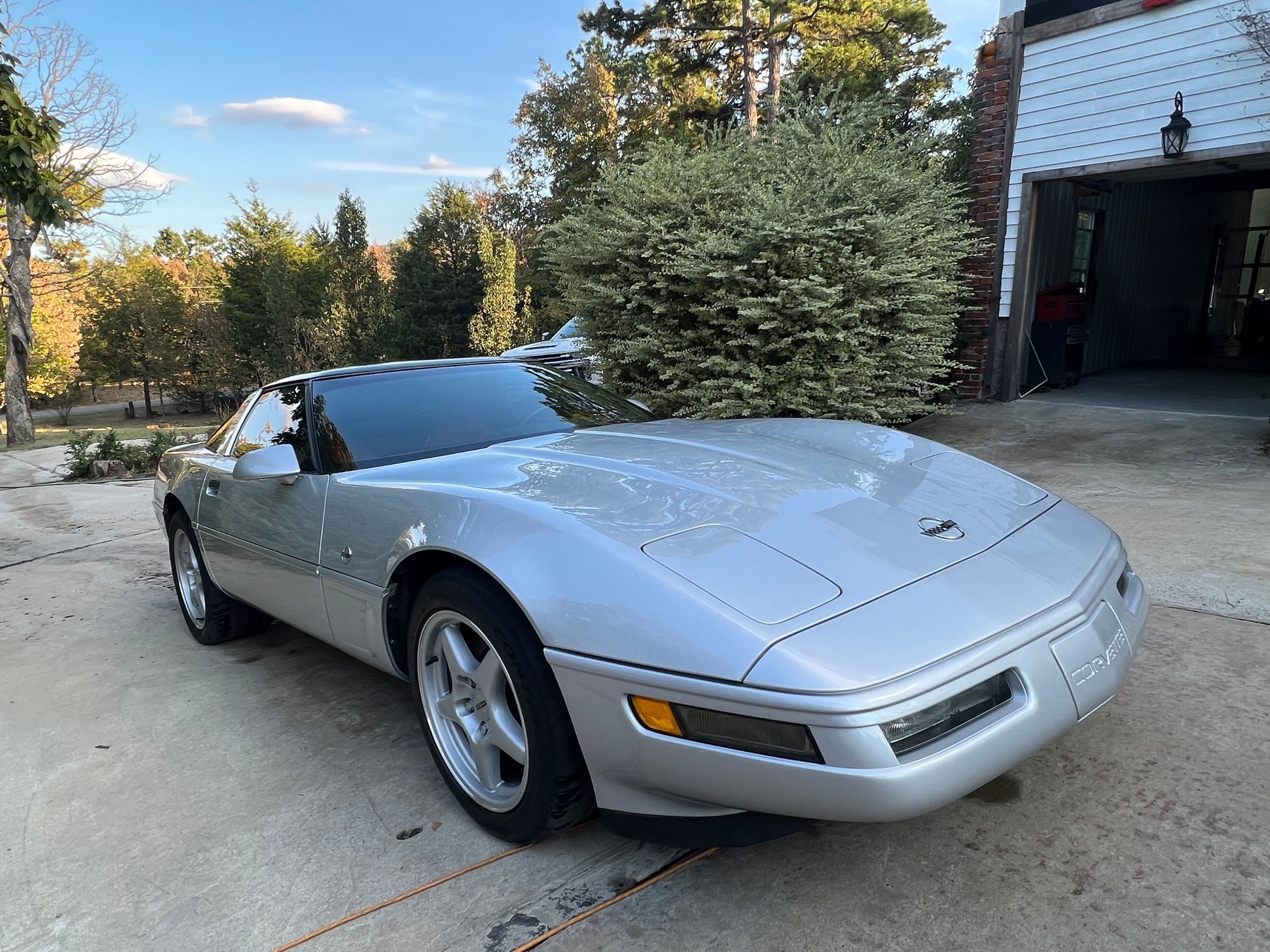

Polished and ceramic coated our C4 this evening. I can’t believe I almost sold this car. It’s in such great condition. It’s a ‘96 collector edition.

Looks great!
I wish my '96 CE looked that good.
