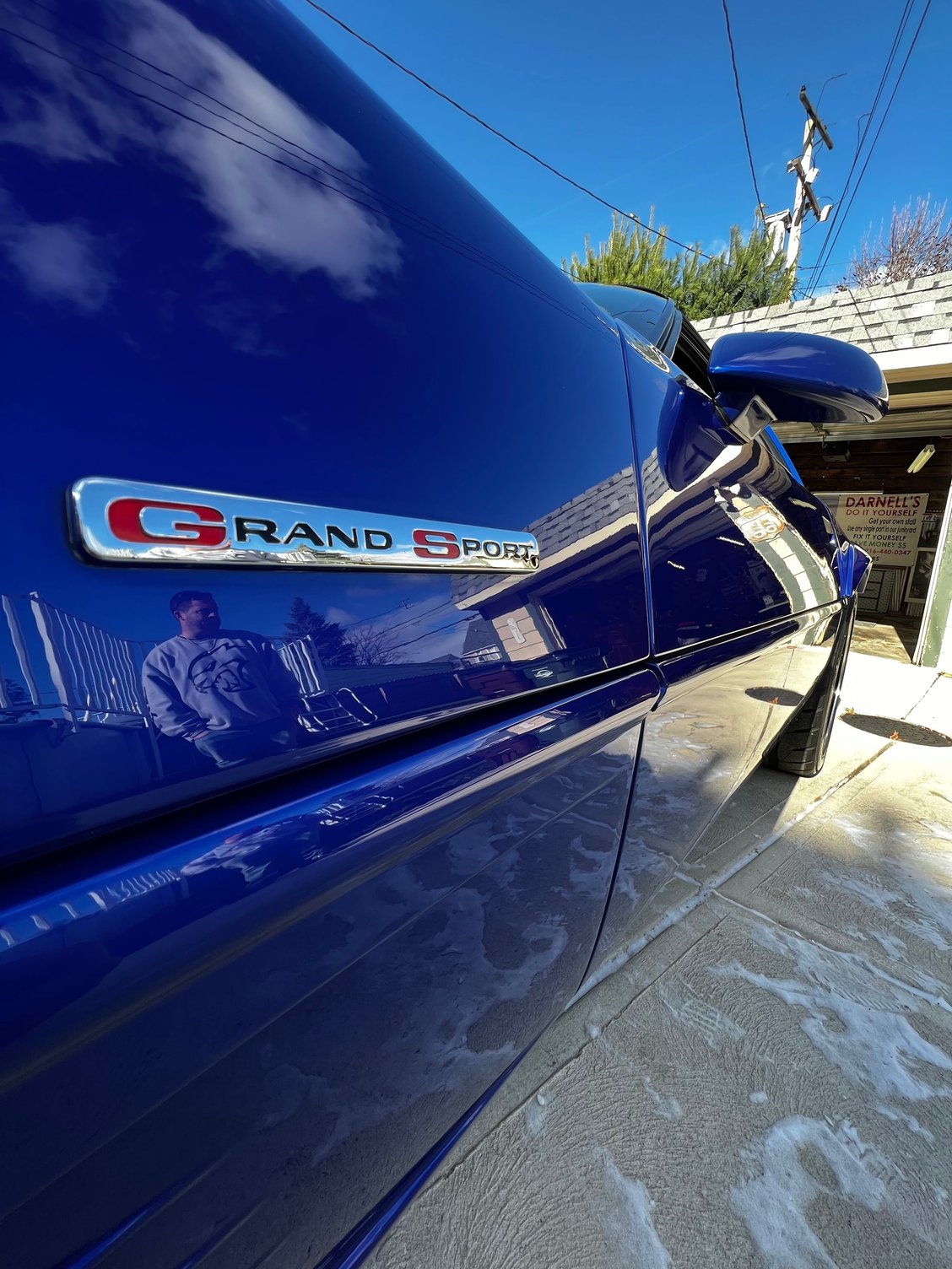

Short version
clay bar
Buff
polish
then a 4th step
ceramic coat to protect it….
just did mine

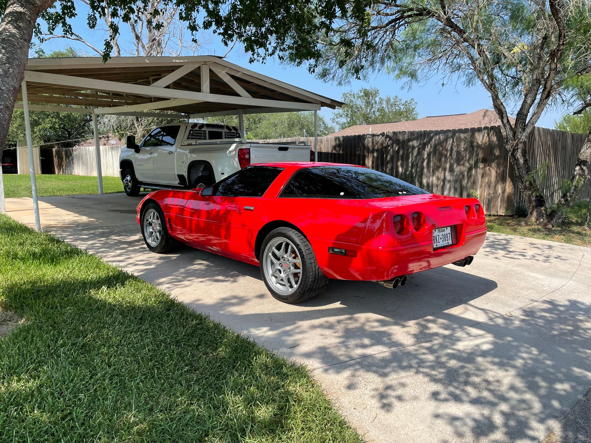

For Paint Correction it's:
1. Spot wet-sand large scratches with 3000grit
2. Compound with wool pad
3. Buff with cutting pad
4: Polish while polishing pad
And you're done. BUT! I would recommend a paint thickness gauge before attempting any compounding. Otherwise you might peel whats left of the clear.
As for Paint Protection:
1) Wash with various boar brushes
2) Clay paint
3) Wash again
4) Seal with preferred sealer

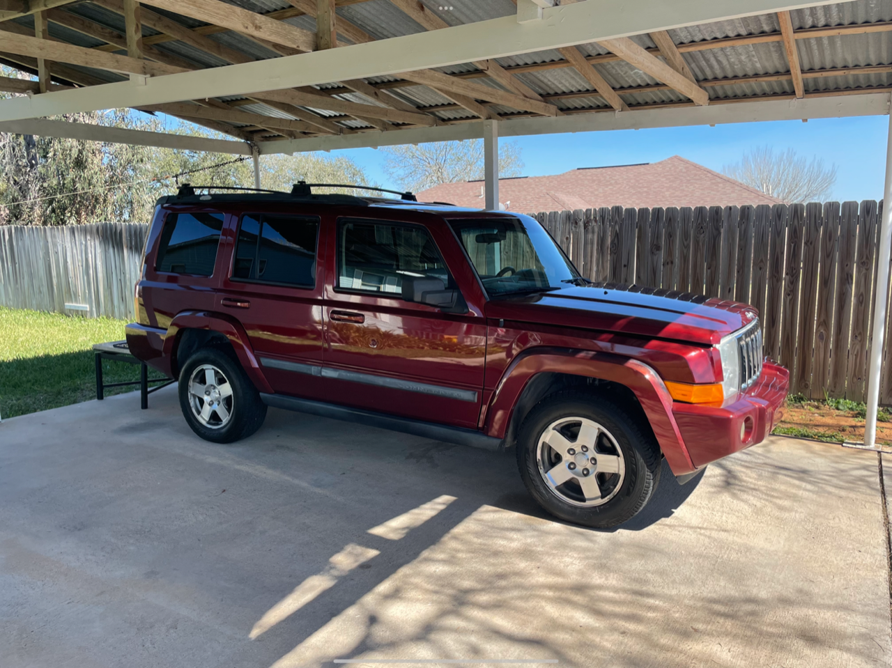

I'll upload a 2009 Jeep Commander I just did shortly. I have a post where I detailed the entire interior on here too.

Old Nov 23, 2022 | 11:48 AM
TheKodiak's Avatar
TheKodiak
Joined: Apr 2022
Posts: 187
Likes: 31
From: South Texas
Here's a list of what I use:
Amazon Amazon
As for the buffer, I bought another one from harbor freight, and it been good to me as well. So you don't have to buy the exact one. As for pads, I would stick to maguiers, I tried harbor freight, and it was a nightmare. Just keep in mind, that when sanding, compounding, and polishing. You're REMOVING layers from your clear-coat. So be gentile, and take it slow. The PO had dogs jumping on the car/paint, but I managed to get most of them off.

depends on what your car needs and your skill level
my GS was really nice an orbital and foam pads were good for all of it except one spot on the roof.

While this is fantastic advice for someone who has some experience, most new comers to the paint correction arena will wind up doing more harm than good when sanding paint. The thinner paints on a C4 will wear quick with sanding and compounding with a wool pad. I’m sure just by the advice you’re giving that you are pretty adept at getting solid results but I’m also sure you’re a good judge of starting out light and if not effective moving up the ladder a bit to get the results your desire. Autogeek has a great YouTube collection of videos for the do-it yourself guy looking for results like the results you got on your Jeep. They also have the best deals on some of the best products out there.
The red C4 you detailed looks amazing. Nice work.
