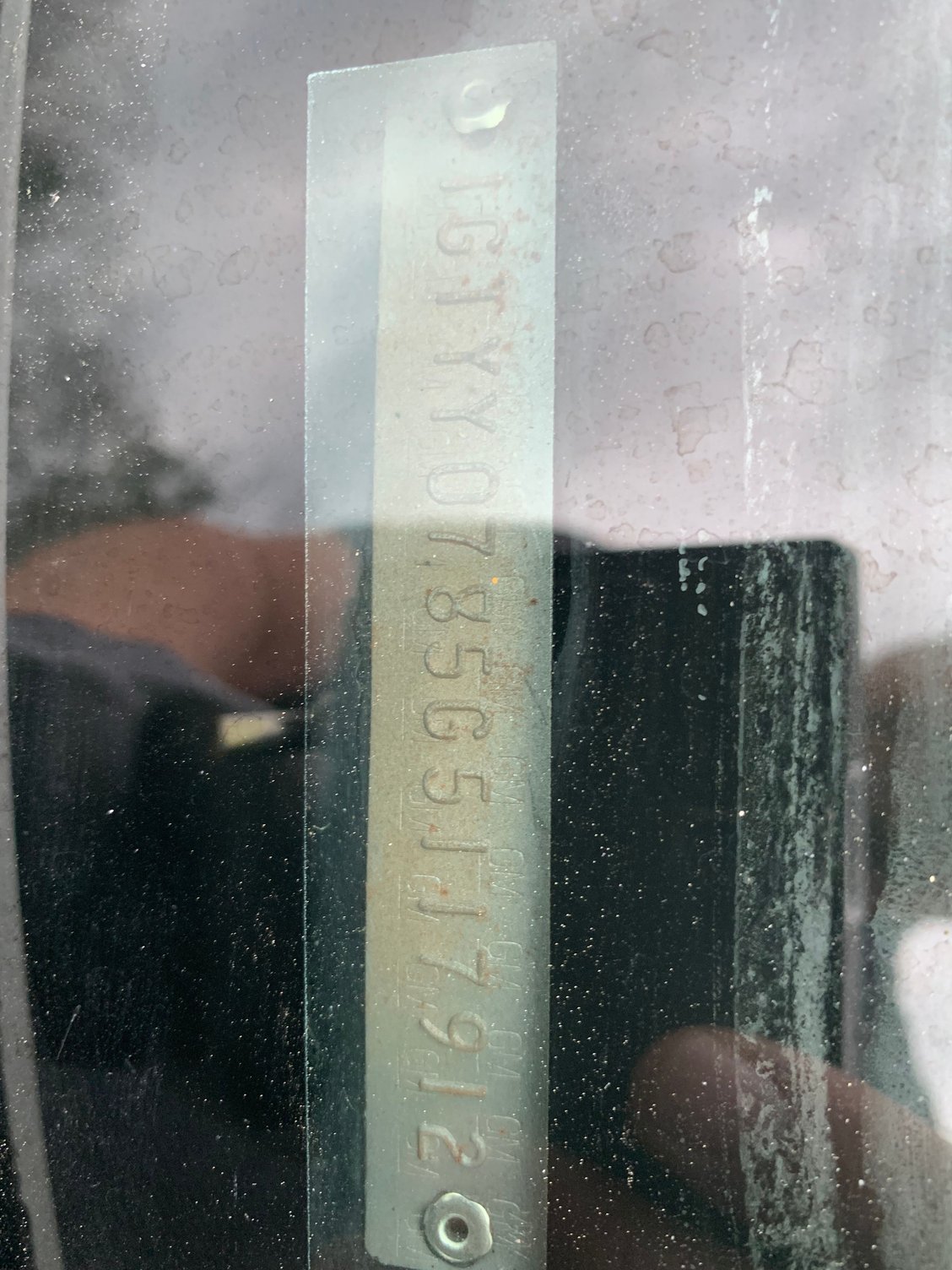

That's considered a VIN 'derivative'. If the engine is original to the car G5117912 should be in the windshield and also on the drivers door 'Certification Label' as the last eight of the VIN.

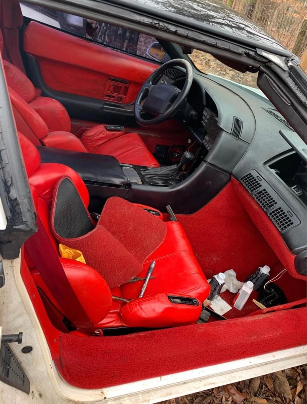

the reason I’m digging into this is the car has been rebuilt and the dash looks newer than 86 and when I’ve been looking up gasket kits for this engine the 86 kits have the valve cover gaskets bolt holes in the 4 corners and mine has the running through the middle, I just want to make sure I get the correct parts so I can get her running again g

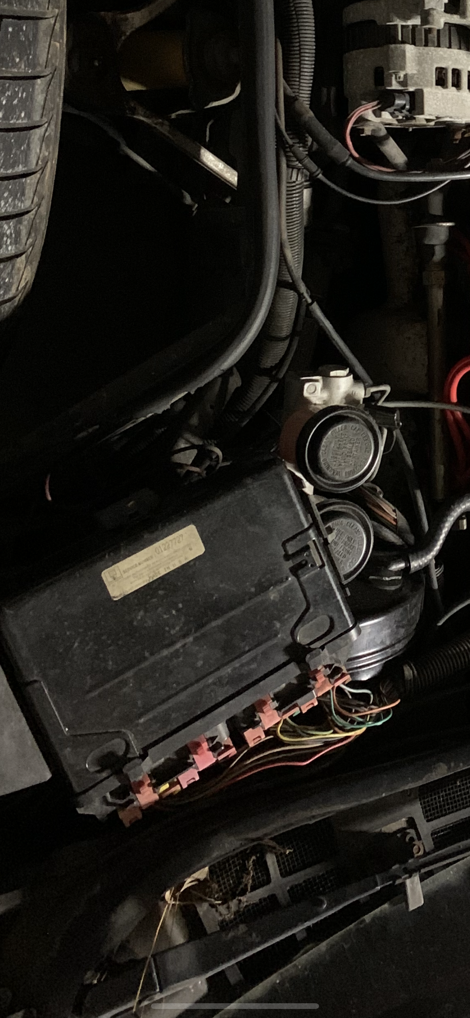

The dash is '90+. Your ECM should be under the hood above/vicinity of battery?

Boy, someone went to a hell of a lot of work to transplant a 2nd gen interior into an 86. You could have later model heads that were put on when the engine was built.

the door label is missing, I can’t find the number on the frame the ecm is above the battery

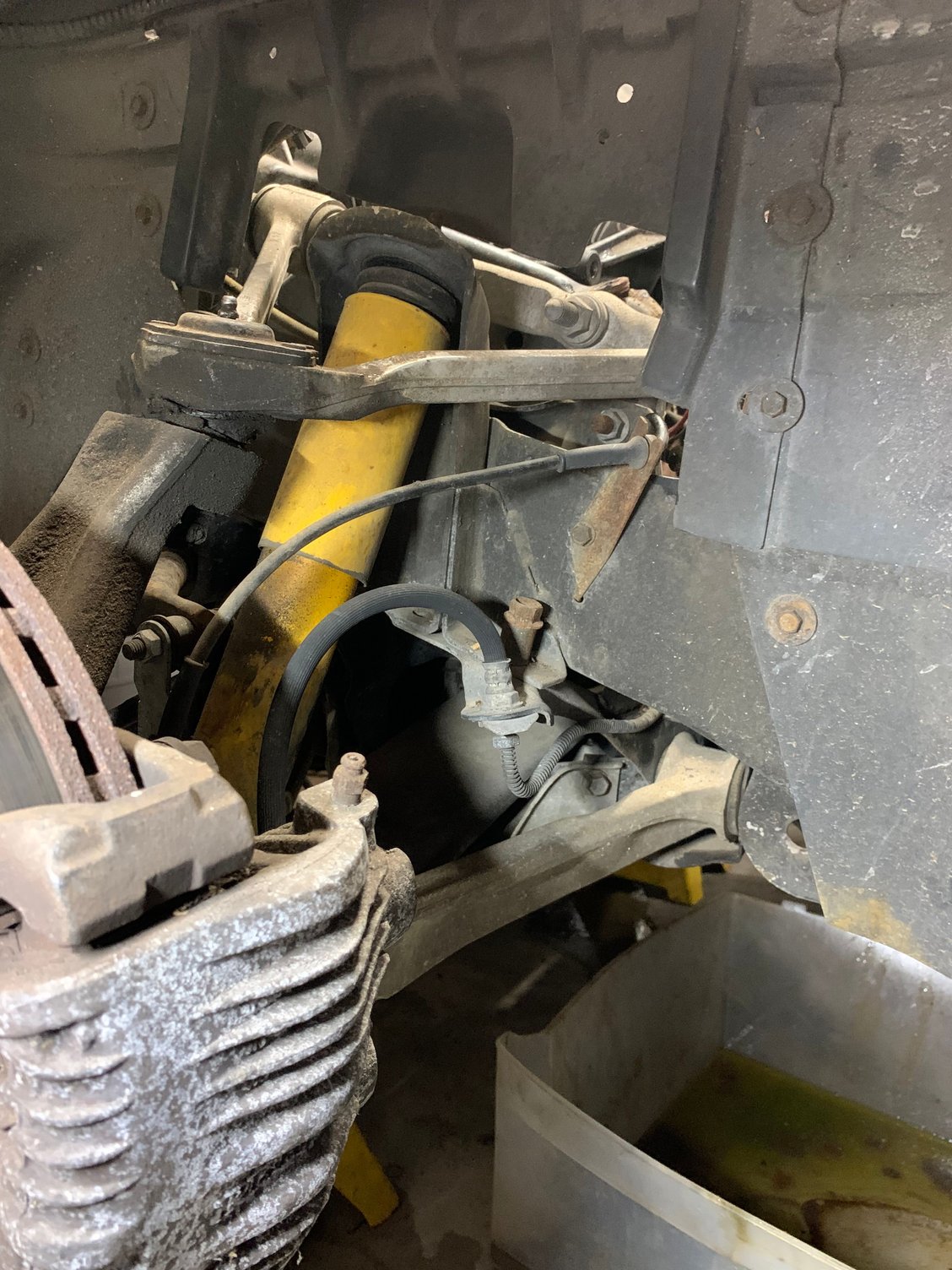

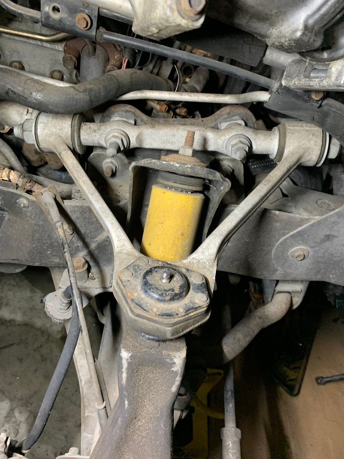

You have the car titled as what? Do you have the title? The year of the chassis could be determined from the appearance of the upper control arms. The flats on an early '84 - '87 are horizontal (parallel to ground) and the later control arms are (vertical).

So those are later '88+ control arms so the chassis is newer than '86, The A/C compressor is a 'denso and they weren't used in 1986 either.
