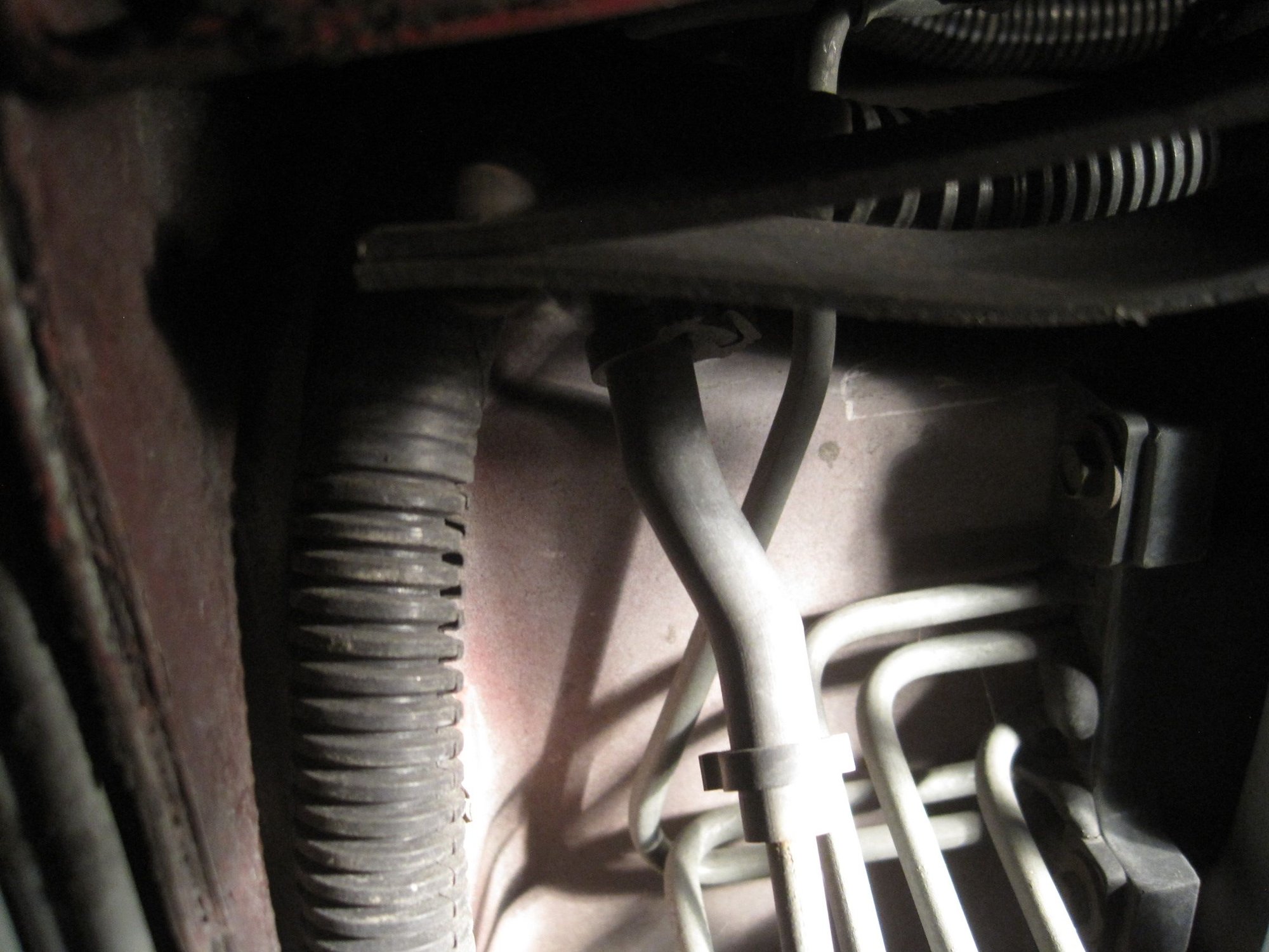

Originally Posted by IHBD
The fuel delivery system begins and ends at the tank. So the regulator itself has nothing to do with this test. If a liquid line such as an o-ring at the filter was leaking air at 3psi, it should be spewing fuel at 45psi. So that's not it.
I can think of two possibilities that are easy to overlook:
A: The seal and gasket under the fuel sender/filler. They will find this with the smoke machine if they remove the gas door and rubber boot.
B: There is a very short hose in the metal vapor line adjacent to all the brake lines where they go into the ABS compartment. About 4" long. You can check this visually without a smoke machine. Forward of the LR tire.
I replaced every last fuel vapor hose from the tank to the canister yesterday. From the tank to the canister is all new fuel hose.
That one in the photo there with the brake lines is one of them that I replaced. There's also another short one, about four inches long, connecting two steel lines there by the differential housing. I replaed that one, too.
Coud be that gasket, but that's basically new, too. A couple of years old, if that, when I replaced the fuel sending unit.
But, yeah, you're right about the liquid lines. Was just thinking out loud there, I guess.
