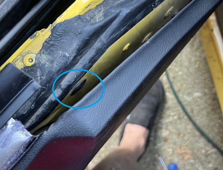

Having a few issues with my new drivers side door panel. I know I’m missing a few pieces but can anyone tell/show me how the top/inner part of the panel secures to the door?
^this is the part I’m trying to figure out

Don't have my door apart, but I would guess that it is held in there by plastic push thingy. It is circled in below picture. It should remove from door and go in a grove in the door panel. There might be a few of them around the door.
ff

the plastic push thingy as you call it holds the vapor barrier up. The only thing holding the door panel is over the top edge by the window. several screws along the bottm of panel and 1 on edge and a couple in the arm rest.

over the top edge by the window? Is that the piece I’m missing in the pic above? I know the defroster piece has two screws but I don’t remember how the rest went

the top of the door panel "hooks" into the window opening gap. You need to lift it up higher than the top of the door, then push towards the outside of the door, than down on the ledge...if that makes sense

Hold the panel up to the door and lower it down so the top of the panel snaps into the top of the door. The rest falls into place.

thanks got it.
